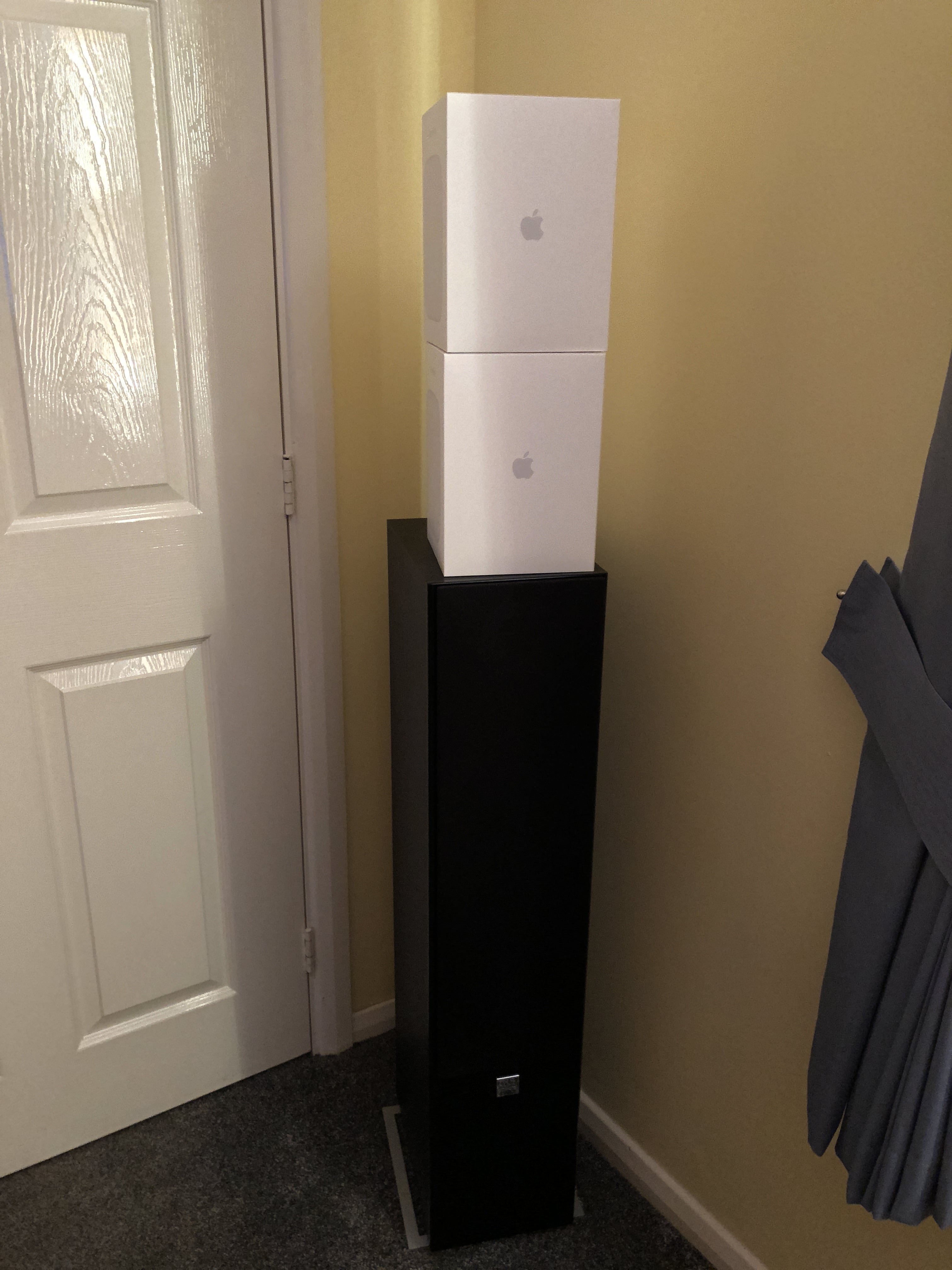

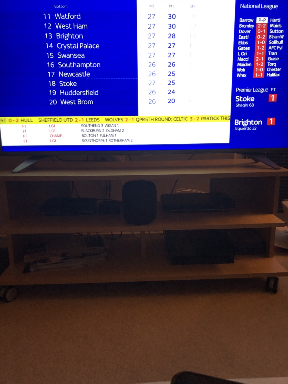

Not sure to keep my HomePod here or not
Does this look a weird place to put it?
I would not put it there, the woofer shoots straight up and you’ll severely limit the soundstage it puts out.
Well I wanted it on top with my TV but doing that takes away some of the screen of my TV. Putting it on the side is where I had it but thought a more central area of the room would be a better fit.
You could always leave it on top with the TV and get a version of the iPhone X experience.

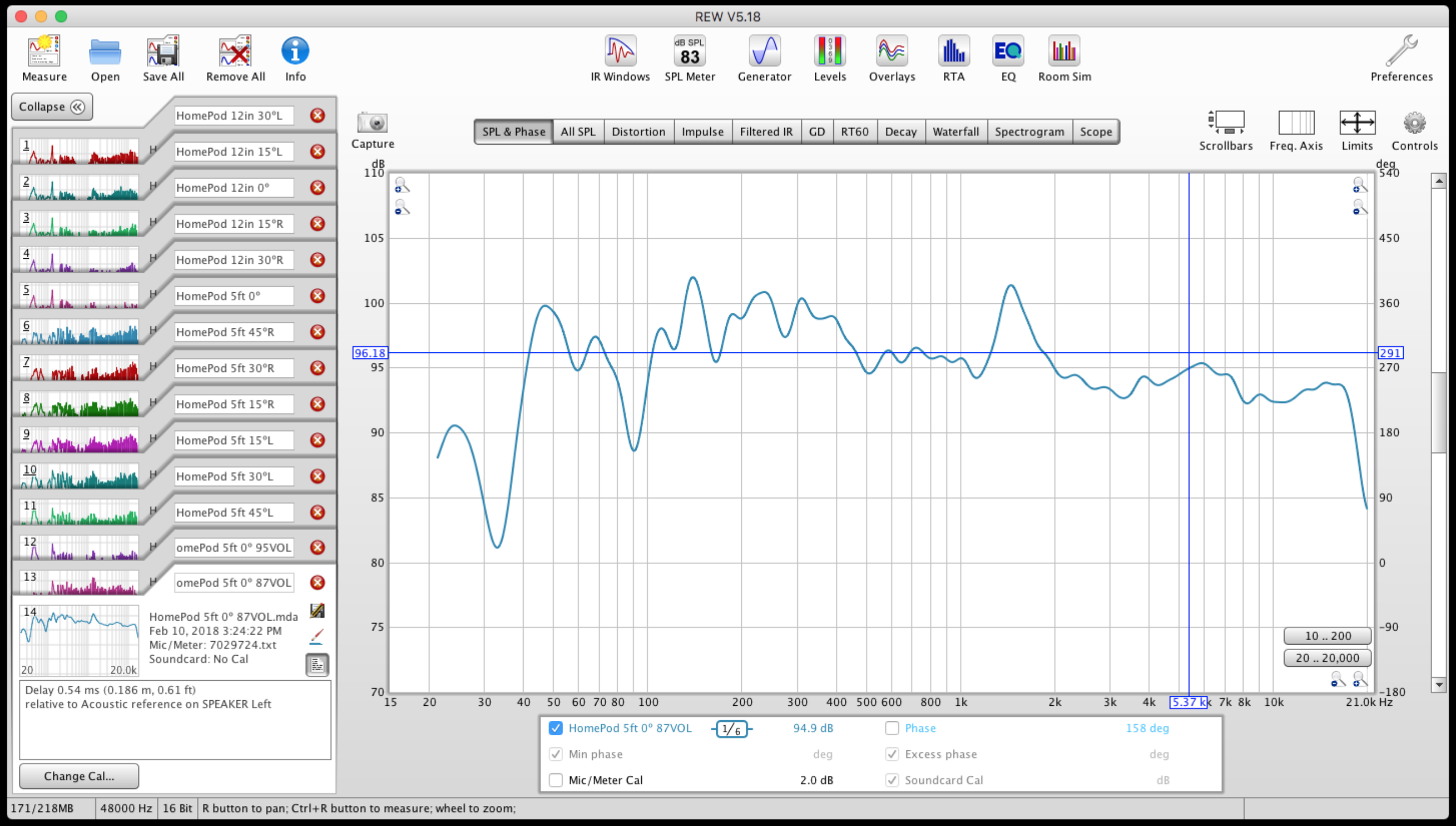

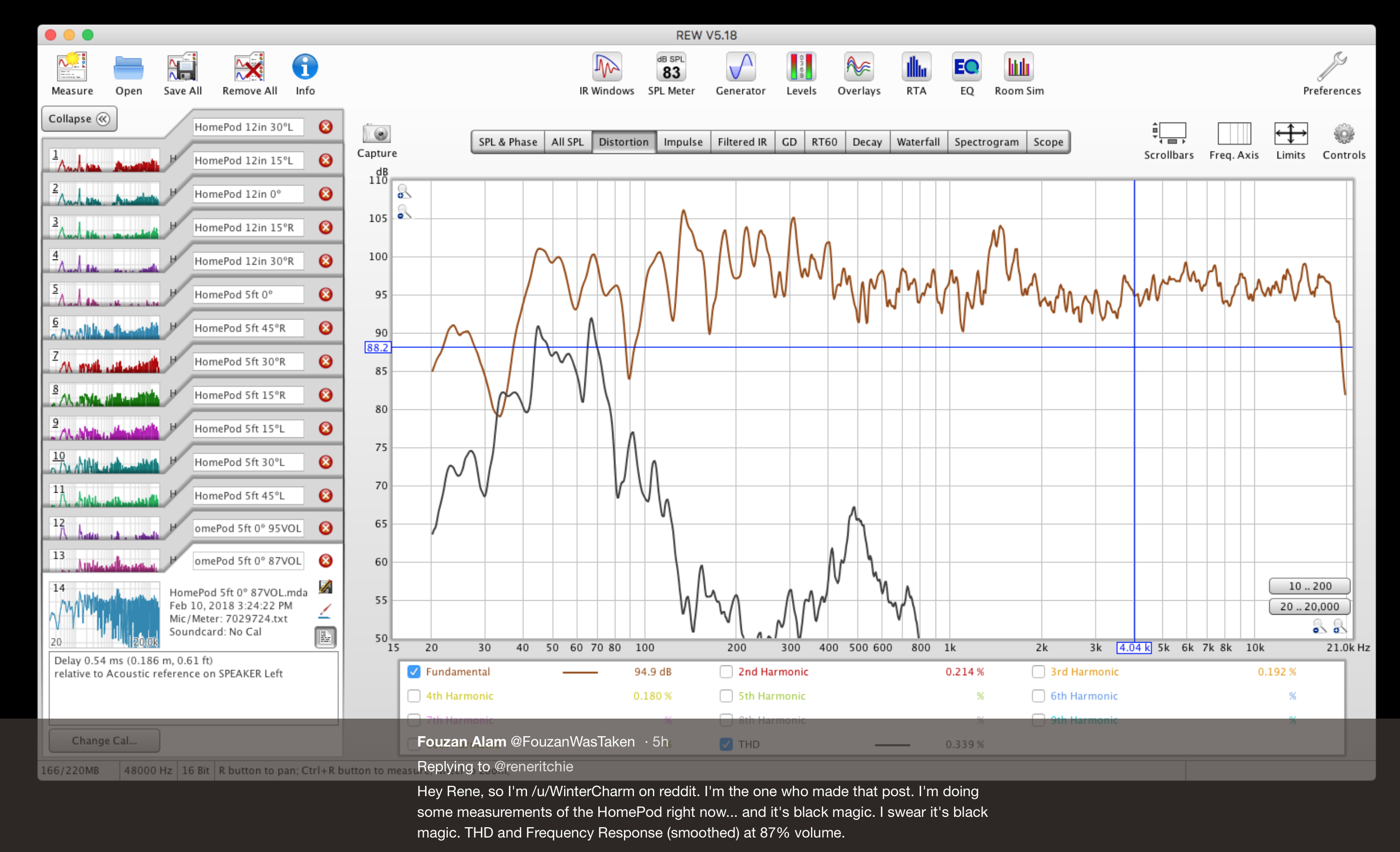

Interesting thread on twitter from someone who says they are an audiophile and engineer.
“I'm doing some measurements of the HomePod right now... and it's black magic. I swear it's black magic.”
“My initial assessment was spot on. The way this thing measures, traditional speakers are dead. Now that I’ve played with it in my apartment head to head against my KEFs... Apple is using witchcraft. This shouldn’t be possible.”
https://twitter.com/FouzanWasTaken/status/962425811356790784

This was the guy who did the initial post on the Reddit audiophile thread.

Things Arve* and I have already figured out:
  1. Apple is applying Fletcher Munson compensation automatically.
  2. Apple’s “tweeters” are actually Balanced Mode Radiators
  3. If you move the HomePod at all, it uses the sounds you’re playing through it to calibrate, so make sure you play music for 2 minutes before making measurements once you move it, otherwise it’ll use the measurement sweeps to self calibrate and your measurements won’t be accurate.
  4. Crossover is somewhere between 200 and 500Hz
    * /r/audiophile admin
Reactions: AppleRobert

[doublepost=1518314571][/doublepost]Arve weighing in:
  • I've looked at ~100 dB-in-room measurements. The bass distortion is beyond spectacular, and I honestly don't think there is any bookshelf-sized speaker that doesn't employ computational audio that will come close
  • They are for all intents and purposes constant-directivity, after they've had time to "settle" - the response takes a few minutes of playing music to settle before measurements are stable - indicative of machine learning being employed
  • They use Fletcher-Munson-like loudness compensation, meaning that they measure differently at 75 and 95 dB. Whether you like this or not is an entirely subjective matter, but it cannot be turned off.
  • Their response is to ~40 Hz, even at extremely high (~95-100 dB) volumes, and the bottom-end cutoff doesn't seem to be a moving target.
  • I had a look at distortion measurements, and while I can't be completely definite, they appear to be better than those of the Kii Three. I'll have to get a pair of both to actually verify, but that one has me flabbergasted.
Not saying everything is rosy: At extremely high volumes (measured 95-100 dB), there is a distortion peak at 500 Hz, which is likely where the "tweeters" have their maximum excursion, about 0.5-2 octaves above their -3 dB point.
But the short answer is: If you can live with not being able to use it with a TV, it's something you should seriously audition, because I'm not entirely sure that there is a bookshelf speaker with a driver less than 6.5" that sounds better on the bottom end.
And:
The response below 400 Hz is flat without room modes actually flat without a single null. /u/WinterCharm also shared a different measurement with me - from a different distance, and 45 degrees off-axis. Only a single null showed up at ~110 Hz, and the speaker appears to be a constant-directivity design with very wide dispersion. How the hell Apple managed that is well beyond me, and could just as well be considered black magic, especially since they don't rely on externalized mic placements for the measurements.

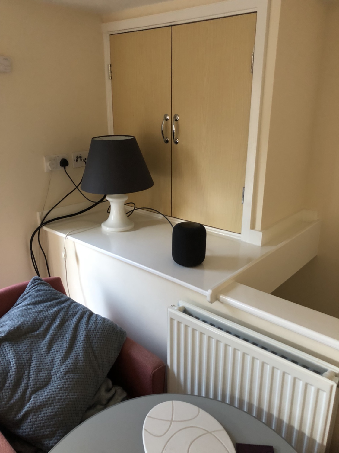

Well, so far so good with my HomePod. The sound is pretty wonderful.
I feel a little lost about the lack of control you have over it out of the box (i'm yet to start digging into the Home app). Even a little more documentation would be of help. I don't really call 3 small discs of paper a full set of documentation! Siri understands both me and my partners requests most of the time. I have noticed on track in my iTunes library that "she" refuses to acknowledge exists; yet I can still see and play it on both my iMac and my iPhone. Weird!

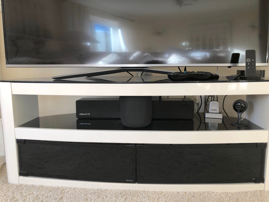

So guess you think I should place mine here
And not under my TV?
Are you going to be AirPlaying audio paired to video from an ATV? If so, then that would be an objectively terrible place to put the speaker. For audio only, if it sounds good there then go for it.
Yes, what he said. You want your ATV sound to look like it’s coming from the TV it needs to be near the TV.
It really depends what your primary listening scenario is going to be.
Yeah my plan would be to use it via my Apple TV as well which is why I moved it here
But if the sound is going to be affected putting it here I will have to rethink it
I wanted it on top where my TV is but I lose part of the screen doing this
That’ll probably do for now then. I’d probably get a couple of shelves to place them left and right if you are planning to get two eventually and you have the space for them.

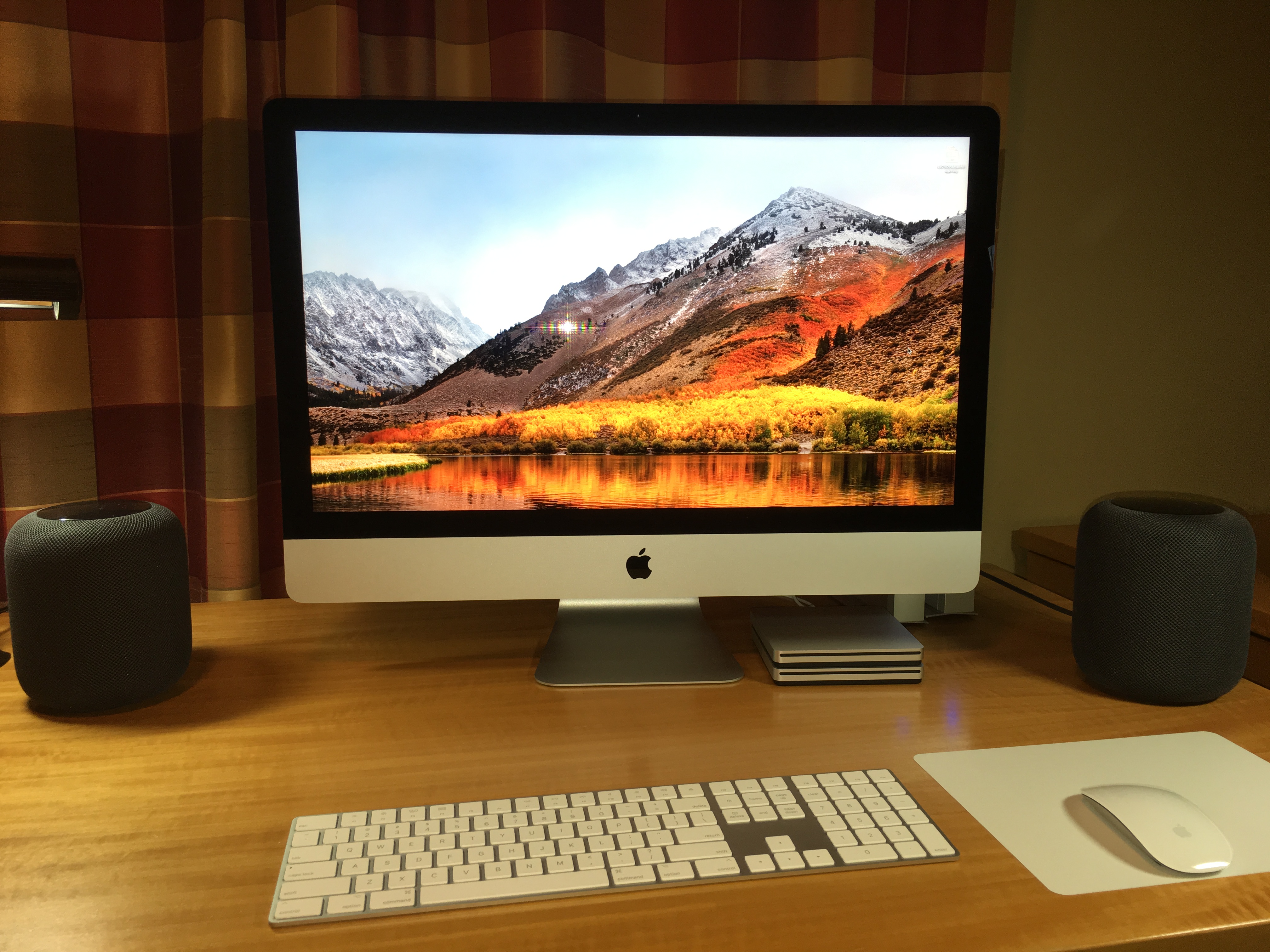

After spending a few hours testing the HomePod I love the thing as does my wife. Siri works surprisingly good even during loud music. I do have Apple Music and really like the tie-in plus the ability to play podcasts.
Sounds quality is very good for such a small speaker. Guessing I will end up with a few more and start to replace my Sonos equipment.

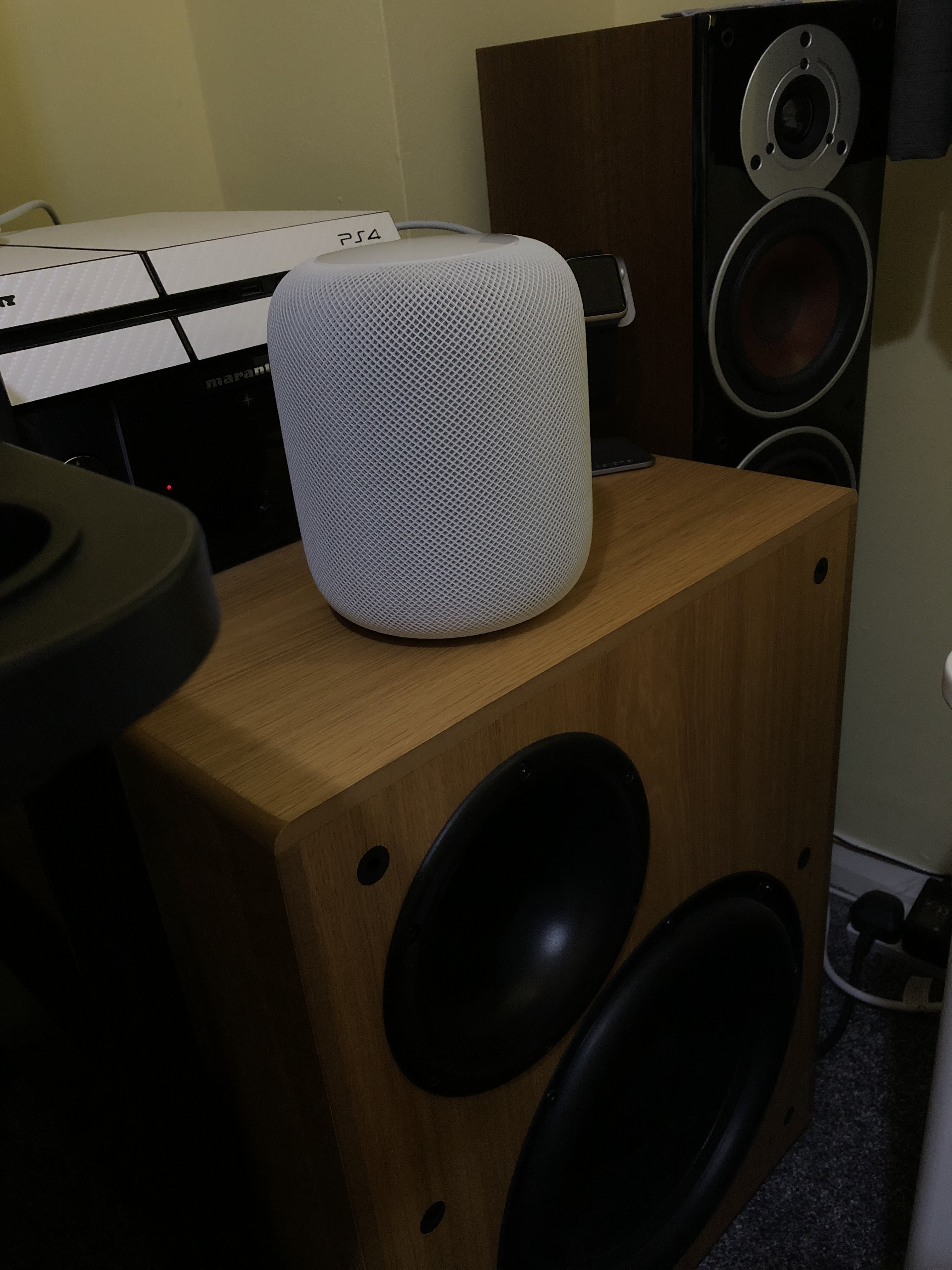

I bought 2 HomePod's, however competition is extremely tough in my house.
In my bedroom I have Dali Zensor 3's coupled with a BK Monolith Subwoofer.
Downstairs I have Dali Zensor 7's, with Dali Zensor 3's as surround and a Dali E12-F Subwoofer.
Now comparing the HomePod to these 2 setups is not fair at all, but my standard are set fairly high. However, after spending time with the HomePod, letting music play throughout the house for a few hours between 20-50% volume (not touching or moving them), the sound seemed to get better (I know speakers can need a little run in period). I started by just using once, getting use to it, how it works, things Siri could do. I thought the vocals and clarity was very good, with bass being very nicely balanced and not overpowering (of course you need a good source, I was playing .AIFF files from iTunes).
It changed when I put the other one on. Wow. These 2 little speakers playing together, roughly 8ft apart, sounded incredible, albeit not true stereo (yet!). Siri worked perfect for me still, only resulting in 1 speaker dimming the sound, it had no trouble hearing my voice. In short, if you like your audio, I would try and get 2 instead of 1 as I don't think someone who likes their audio a fair bit will be too impressed. The ease of use, ability to move it to another room is very handy. I will probably end up buying more in future.
I’m in the same boat as you. It is below the TV on a shelf...and that shelf also has a lip. I did put it in front of the TV to test it for a bit and it sounded so much better. Tried it across the room and whilst it sounded amazing, it want natural for the Apple TV - that is my 90% use case. I’m now thinking behind the TV, though that may cause Siri issues.
