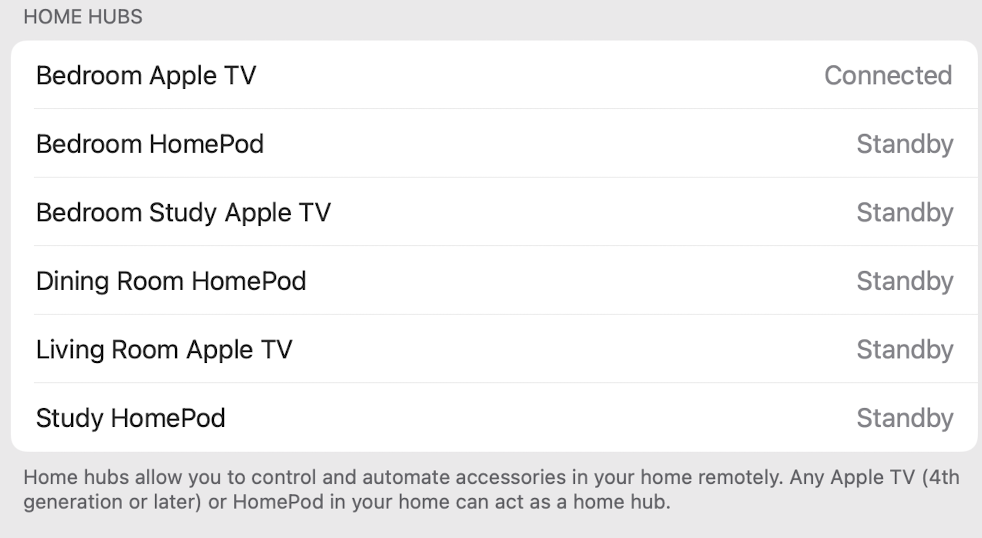

The only possible change that I have noticed is that the homekit hub seems to have switched to one of the homepods while it used to be one of the Apple TVs earlier (i see 6 possible bridges , 3 homepods and 3 ATVs, also curiously, I dont see ipads as standvy hubs any longer)
But again, the last time I went digging into the settings > hub list was a long time ago so this could be a red herring.

On the topic at hand, it seems I have been able to resolve it by:
a) Switching off all homepods
b) Waiting 5 minutes while trying to access home app from a phone disconnected from wifi (to emulate remote access)
c) Switching them back on once an Apple TV started showing as the designated hub
With the ATV as designated hub, things seem to be working fine as of now - not sure if it's because the ATVs are hard wired to gigabit CAT6 or if the homepod as home hub software stack is buggy at the moment.
I just hope it continues to remain this way- fingers crossed!

FWIW, I always found that my ATV’s are more reliable as Hubs than the HomePods are, especially the ones hardwired to ethernet. Found the iPads to be horrible.
