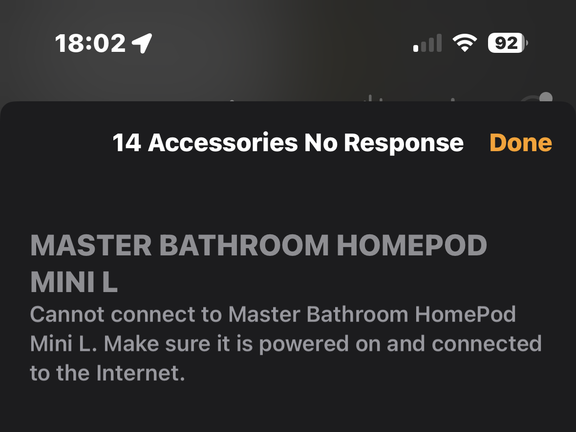

Anyone have a HomePod Mini die for no apparent reason? I noticed it was No Response in HomeKit and also disconnected from Wi-Fi in the eero app. Tried a power cycle and then a factory reset but it’s showing no signs of life. Display not turning on at all and of course I’m just a month out of warranty.

Worst part is, I removed it from my Home and now I have a perpetual indication that the removed HomePod is No Response. Great!

Now I still got this alert in the Home app that that HomePod isn’t responding which sucks. That stayed even though I removed the HomePod from the Home app while troubleshooting.
