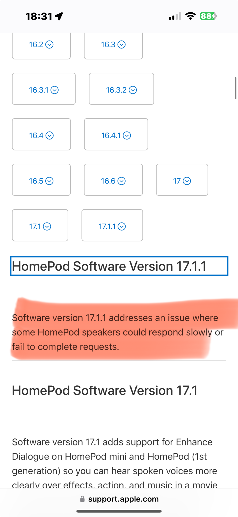

17.1.1 was supposed to fix this. It’s the main key point in the change log. Oh Apple, what a mess you’ve created with these things.

From the Apple Support page…
They literally had one job with this software update 🤦‍♂️
