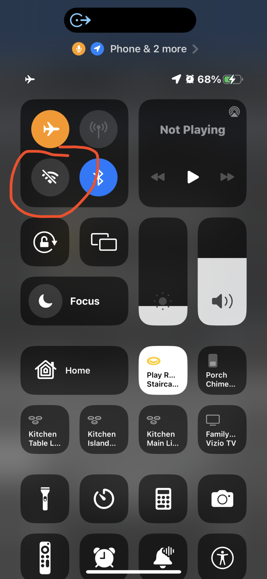

So a grayed out Wi-Fi icon in control center with a diagonal line going through it means Wi-Fi is still active? I mean, this is what I saw when I verified it was off. If not then that’s extremely confusing lol.
Your Wi-Fi is off in your screenshot. What he's saying is that it's possible for Wi-Fi to remain on even if Airplane mode is on.
For example, in your screenshot, if you were to tap the Wi-Fi button to turn it on, then turn Airplane mode off...your Wi-Fi wouldn't go off the next time you go into Airplane mode. The same applies to Bluetooth. Notice how your Bluetooth is still on even though you're in Airplane mode.
But, wait...there's more! Bluetooth is even more confusing. If you want to turn Bluetooth off completely, then you have to do it through Settings. Tapping the Bluetooth button in the Control Center only just disconnects Bluetooth devices. Notice the difference between it being partially grayed out (Bluetooth on, devices disconnected), and completely grayed out with a line through it (Bluetooth off).
This is getting out of hand so I won’t argue it further lol. Regardless, my point here is that Wi-Fi was indeed off for me and I confirmed it was off before testing the feature he’s asking about. I screenshot exactly what I saw at the time.
