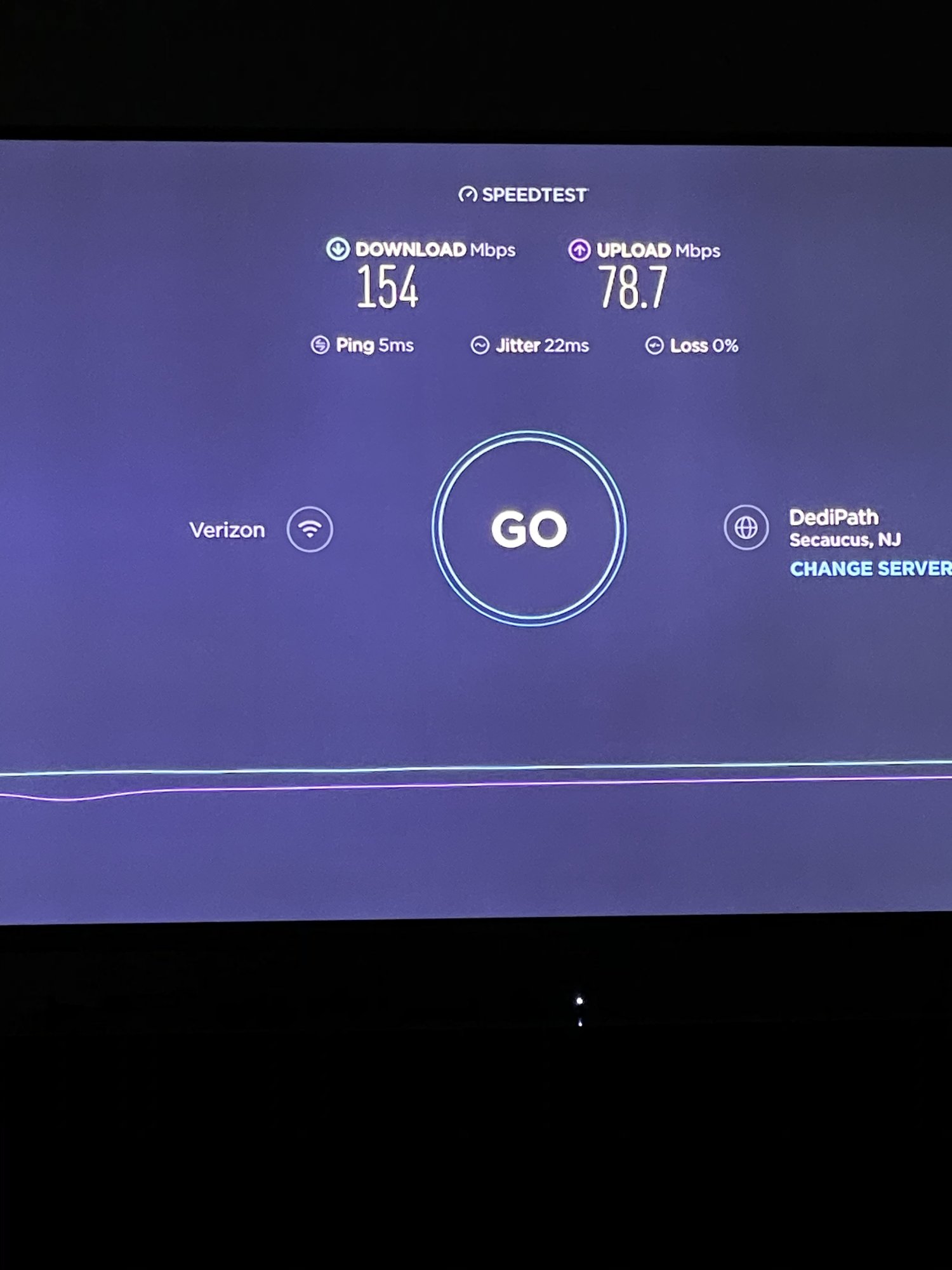

Are you using the Ookla Speedtest app on the ATV to test this?
If so, this is what I got (Verizon GB speed, not near a router)

Yes, I am using the speed test app on the ATV.
Thank you very much. Well, those are very good results. I have an old and trusty Airport Extreme AC serving me wifi, and normally I get 300/300 with a 10ms ping in the Apple TV, rock solid. But when I select the Homepods as the default output of the ATV, my speed goes from that to 2.4/1.2 and the pings goes to 120ms.

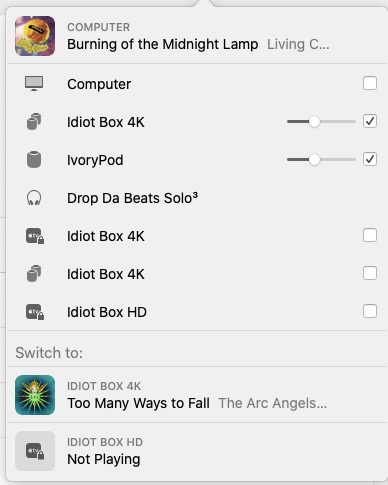

Could guide me step by step in how you are doing it?. That is, in the airplay menu when you select the Homepods that are set as the default output of the ATV they now appear with an Apple TV icon by their side , right?. If you choose it, the ATV doesn´t turn on?.
This is the AirPlay menu in my copy of Music, running on my laptop. As you can see it is a mess. And the stereo pair HomePods are actually duplicated and you can’t tell which is the right one. So what I had to do was just choose one or the other until it worked.
