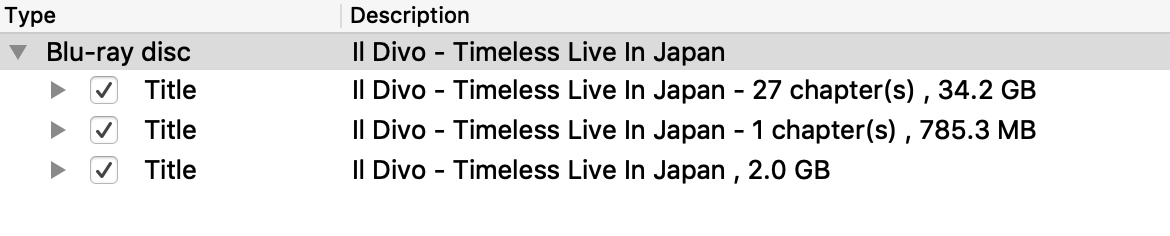

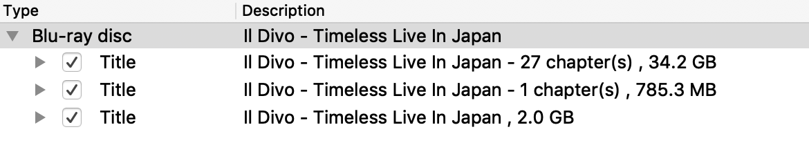

It's not really trial and error. In most cases the largest title is the movie, smaller titles are extras or things like copyright notices.
In this case it is clear that the 34.2 GB title is the move, and the other 2 are extras. In the simplest case all show up as separate movies. Integrating extras as extras depends upon the client you are using.
Subtitles and audio tracks are selectable, client dependent.
