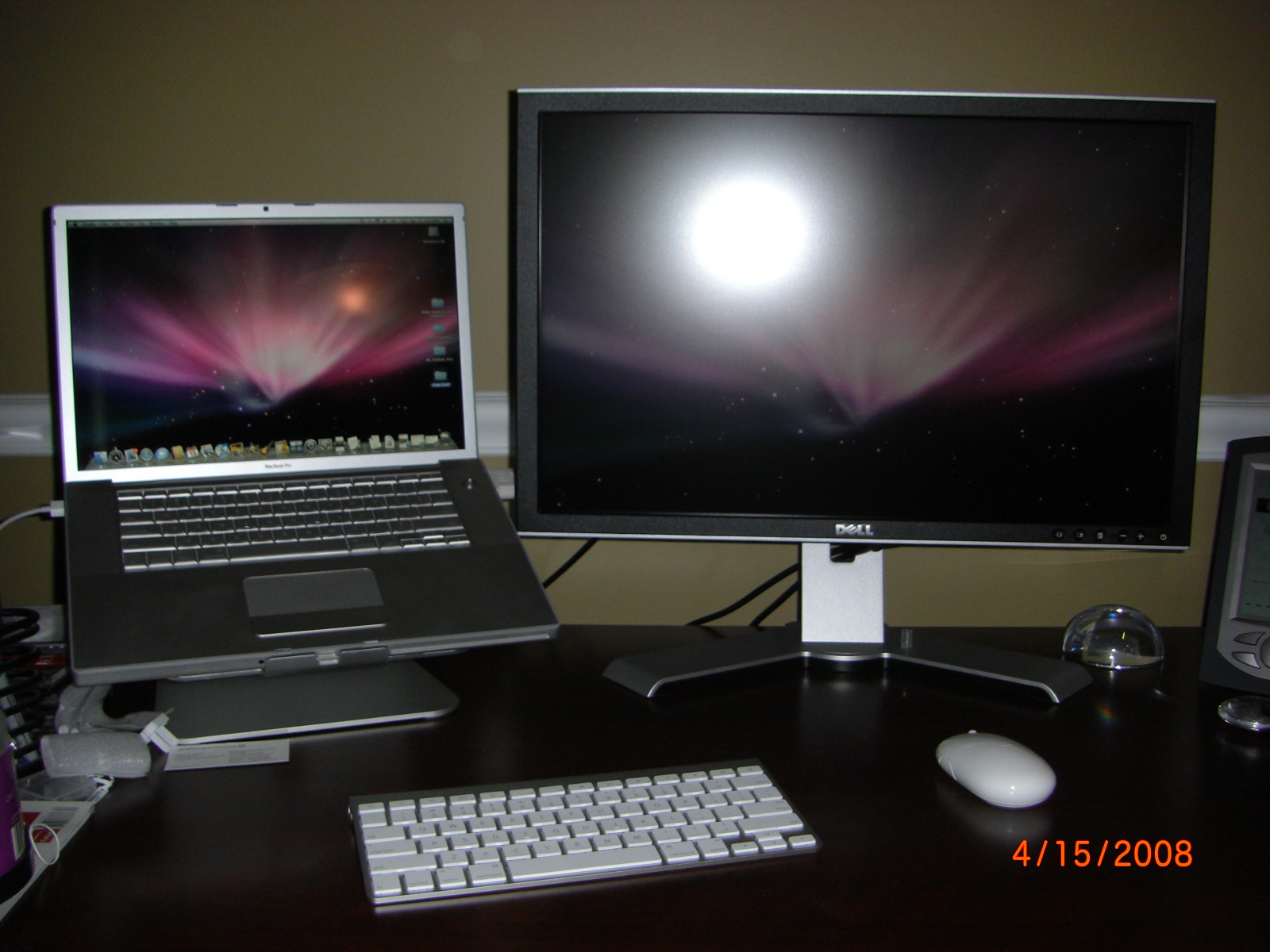

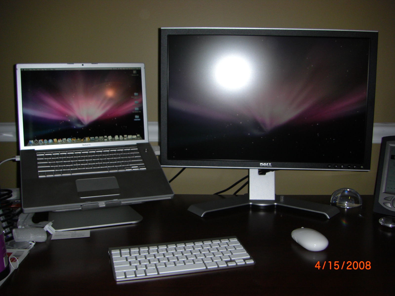

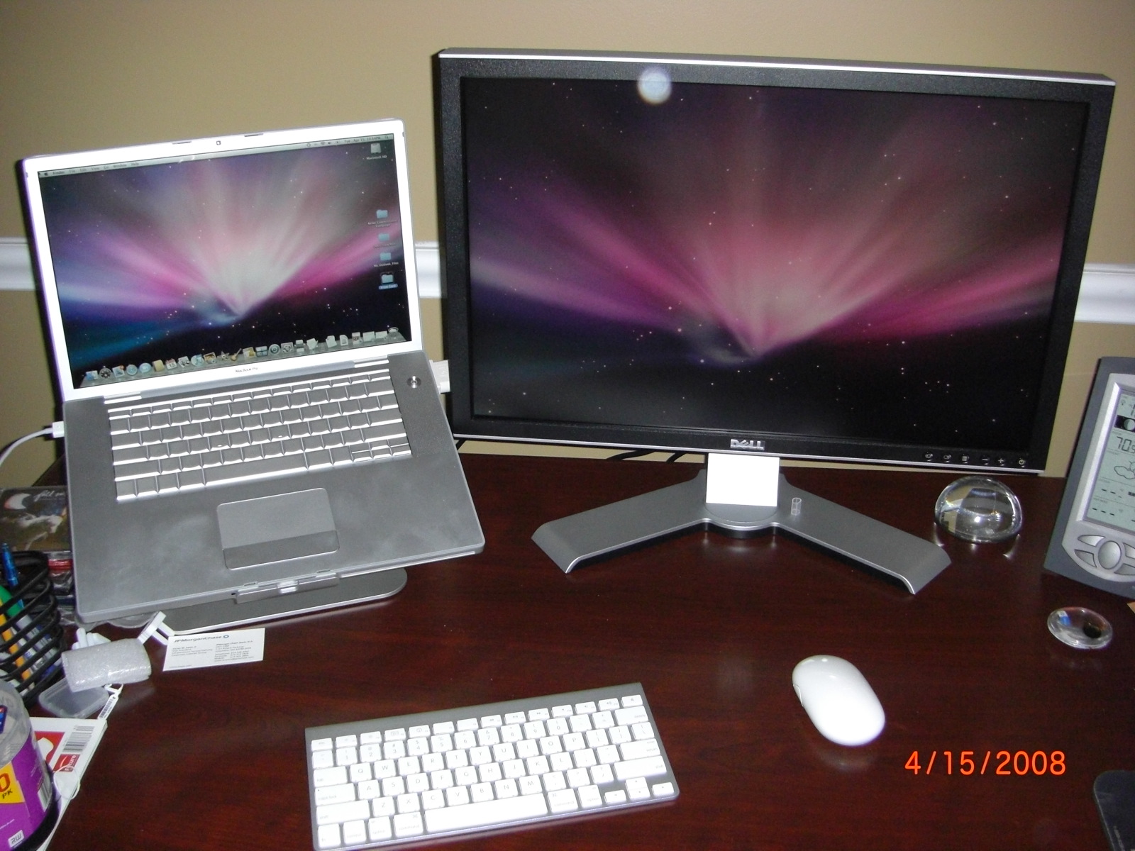

Techlover I got your PM but can't figure out how to attach pictures in a PM, so here are a couple of shots of my setup...
