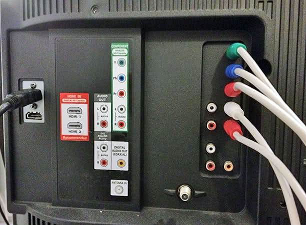

So I've been hooking up my 13" Macbook Pro to the TV to watch movies.
I'd like to use the speakers from my TV as an output, but have no idea how.
I currently have a mini DVI to HDMI adapter plugged into my Macbook. The adapter is in my TV's HDMI1 port (there are three). Only issue is that audio is lost, since DVI is a video standard.
Now I have a cable with a minijack on one end and composite audio (red/white stereo) on the other, but I don't really know what do with it, because the HDMI channel on my TV doesn't try to fallback to the composite audio (I think).
Here's a photo of my setup, any advice? (save purchasing an external speaker system, I don't want to do that)
(I've tried plugging in the red/white from the macbook into the two slots on the left, the five wires to the right are video component from my cable receiver box)

I know this is a bit late, but the ports labeled "DVI Analog Audio" are where you want to connect the audio from your MacBook. Your manual should say which HDMI port matches, or just trial and error, be in 1 or 3.

Interesting, although I don't think my TV will comply with this set up, audio is lost because I was using DVI, which is a video only port.

Here's the best way and cheapest way I researched and just did it successfully. Use the mini dvi to Hdmi cable. It's readily available at best buy or apple store. Hook that up to your Hdmi port on your tv. Now you have video. Take an 1/8th inch stereo audio cable and run it from the Mac audio out jack to the audio in to the tv. You may need an adapter to go to 2 RCA jacks. Consult your owners manual to the tv because it might specify which Hdmi jack has the capability to run seperate audio. All vizio TVs use hdmi2 only. The audio jacks to use are usually right next to the proper Hdmi jack. Important note. Use the Hdmi to mini dvi cable with no other adapters in there. The audio pin is grounded and tells the tv there ain't no audio on the Hdmi jack so the tv goes to the analog audio jacks. Some adapters leave this pin open and the Hdmi circuit still looks for audio. Sony tvs automatically sense the seperate audio signal. You have to read the manual ( I know I hate doing that too). You still set your Mac display settings to mirror.

I've been searching the web for like an hour and a half trying to figure out how to get this to work and all I had to do was switch the hdmi port. lol I knew I wasn't stupid. I plugged the cable into the headphone jack on the macbook and audio in on the tv, but the missing puzzle was switching the HDMI port. Life Saver!!
