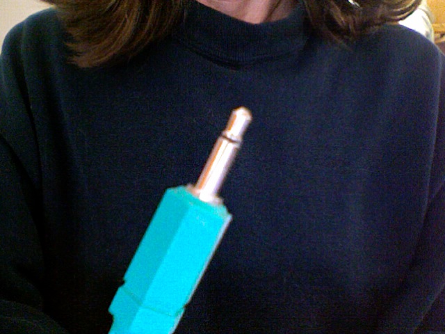

Can you take a picture of the connector of the speakers, as well try to use the port with headphones or other speakers to try and eliminate that variable.
Here is a photo of the speaker connector. I have no other speakers to try. Tell me this: If the speakers were dead, would they possibly not be recognized by the computer? My son told me he couldn't get them to work in his PC. I may have wasted your time. Sorry about that!

Well, if they don't work I honestly don't know how the computer will react.
However, we should be sure the speakers are powered. Are they plugged into the wall or have batteries installed? I've had people call me when I sold them a computer because they forgot to plug the speaker into a power source 😛 it happens.
If it's not plugged into a power source, check for the regular power-jacks on the speaker itself or a battery compartment.
Also, FYI, you informed me the speakers were digital, that is an analog connector. For future reference if it has that long metal plug it is analog 😀
