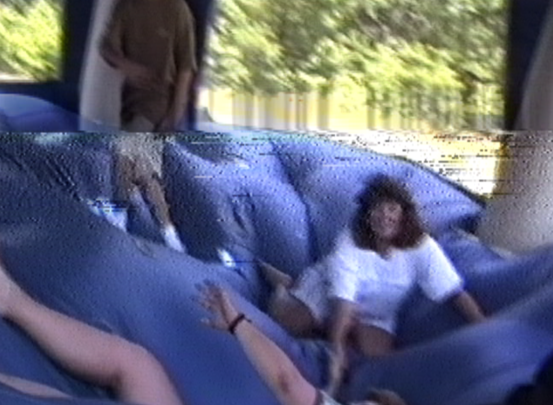

I recently began converting my old collection of Hi8 tapes to digital using a Canopus ADVC-300. As for my camera, I'm using an old Sharp, model number VL-H860. So far, I've been pleased with the quality that the ADVC-300 provides. However, I have noticed that occasionally, there will be momentary horizontal jitters that flash onto the screen. These jitters last only a fraction of a second, and usually appear towards the middle of the screen (although I think I've seen them other places). I don't think it's a problem with the tape, because when I rewind it, the jitter does not occur in the same spot.
I also thought that perhaps the Hi8 heads were dirty, so I purchased a dry Dynex cleaning cassette from Best Buy and have run that through multiple times. So far, the occasional jitter still appears.
As you can imagine, I'm trying to convert these tapes at the highest quality possible (hence my splurge on the ADVC-300), and would like to preserve these memories without the occasional horizontal lines.
Does anyone know what these are from and what causes them? I'll try to take a screenshot from iMovie and post it later. Any help would be greatly appreciated.
Thanks.
Here is a screenshot. The flash of horizontal distortion only lasts for a single frame, but it is still very noticeable when the video is played back at normal speed. Again, when I rewind the tape, the distortion is not there.

As for your question, do these "jitters" appear on your screen when you capture the video? If the video is fine in the digital copy, which in your case is your hard drive, then I don't see the problem. It could be that your camera is just simply getting old.🙁

They do appear when I am capturing the video (in the iMovie capture preview box) and during playback. Also, even though the camera is older, it hasn't seen a ton of use, so I'm not too worried about the wear and tear on the camera. I just purchased a wet cleaning solution on eBay, so I'm going to try that.

Thanks for the help David. Unfortunately, however, my hard drive copies are affected. Upon playback, I have the same distortion, so I think it's a problem with the camera that's attached to the capture device. So, even though there is no problem with the tape itself, I'm trying to capture them soon before deterioration eats at them further, which is why I have a sense of urgency.

I'd look on craig's list or eBay for another Hi8 camera to try. Consumer cameras don't adhere to tight tolerances like professional equipment does so tracking problems are much more common. It's not uncommon for some shipping cameras to be so out-of-spec that the tapes can only be played back properly on the cameras they were shot on.
