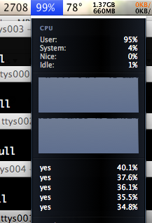

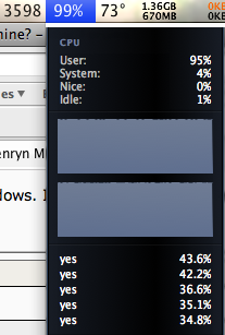

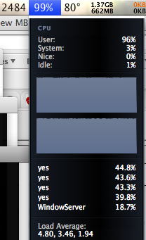

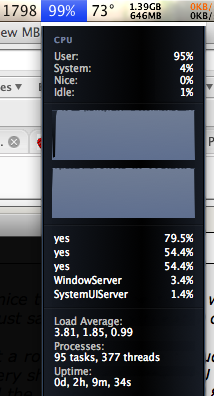

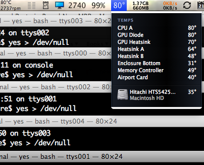

I did
Code:
%yes > /dev/null
and watch the temp go up and did some screen caps .. hope that might be of interest to some..
first 30 second or so .. starting with three instances of
Code:
%yes > /dev/null
60sec.. 90sec .... and watch it go up to 80˚C. Note fan still running at 1800RPM
Added another instance.. and Fan speed starts to climb.. but only up to ~2600 RPM.
Added another instance.. and Fan speed still won't go past 2600RPM. CPU temp @ 80˚C now. Won't go past that. That was at 9 minute.
Then at 11 min, I manually increased the Fan Speed to ~3600. Note the temp dropped to 74˚C at once. just stay around that range.
Final cap was taken at 20 mins or so and... the temp was stable at that...
CPU A - 73˚c
Fan Speed - 3600RPM.
with 5 instances running.
