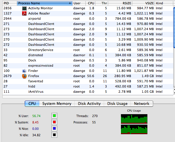

Activity Monitor - I have been sent there before, I thought it was/is sometimes not as fast as it once was, but when I get to Activity Monitor, I have absolutely NO IDEA what I'm looking at, much less, what to do.
If I quit some of the processes, would that help with temp??? What ones am I able to quit without damaging anything that the computer actually needs to run properly???
I took a screenshot, there are many many more processes that are running, I took the screenshot before it was finished loading.

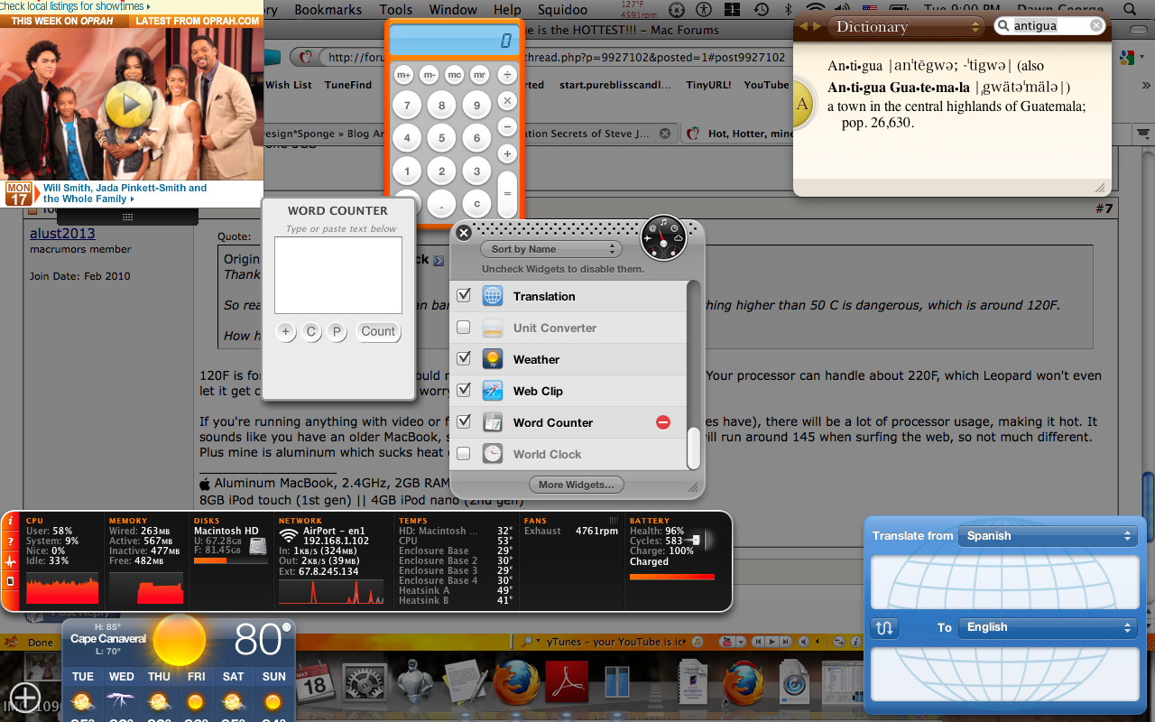

120F is for the hard drive, which should never get that hot no matter what you do. Your processor can handle about 220F, which Leopard won't even let it get close to. You don't have to worry about it.
If you're running anything with video or flash embedded into it (which many websites have), there will be a lot of processor usage, making it hot. It sounds like you have an older MacBook, so your temps will be different, but mine will run around 145 when surfing the web, so not much different. Plus mine is aluminum which sucks heat out of the computer too.

Would you post another screen shot of Activity Monitor showing All Processes and sorting the by CPU %?
There's something using a lot of CPU time according to iStat.

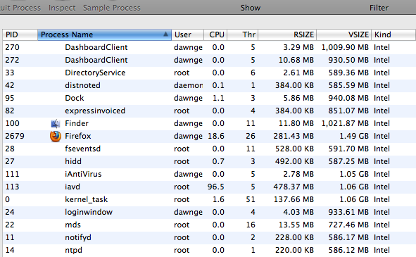

I guess I didn't do that for my last message.....this is what you're talking about right?? Had to take 2 pics

But luckily for you, I have an easier solution. A process called iavd is sucking up 96% of your processor, which very well could be the cause. I won't attack you for having AV on a Mac (you shouldn't need it), but I would recommend you disable the iAntiVirus background protection (I think the setting is called "Protect my Mac"). Hopefully that will speed things up and make your temps go down.

The screenshots are all good, but please click on the CPU tab to sort by CPU. You left it at the default settings so it sorts by name. But we want to see which processes consume a lot of CPU power. Therefore, please click on the CPU tab so that the higher numbers are on top.
Also we can already see that firefox is using a lot of CPU, how many tabs do you have open? Using Flash?

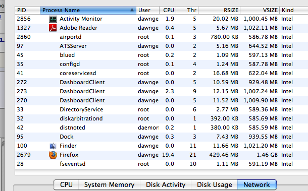

Ok, here goes. I went ahead and quit Antivirus and that other one, temp went down 10 degrees pretty fast. Here is a screenshot with it sorted like you said.
Right now, I have 5 tabs open in 1 window, 3 in another and 2 ebooks in Adobe. Not running anything with Flash.

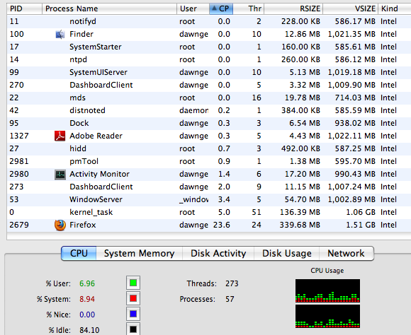

Oh yeah, in Activity Monitor, the left column called PID.....what is that? Wondering cause for Firefox alone there are 2679 PID???? 2981 pmTool, 2980 Activity Monitor, 2996 BrowserPlusCore.....any of these possibly responsible for running hot OR slow??
PID = Process ID. It's just the number OS X uses to keep track of the program.
Anyway, your usage percentage looks MUCH better without anti-virus running. I'd bet that was your biggest problem as far as temperature goes.

Firefox still looks like it's using a lot of CPU - 23% in the snapshot you posted. That will make the CPU quite warm. Quit Firefox, let it cool for a couple of minutes, then look at the temperature. You should see about 120 - 130 F
