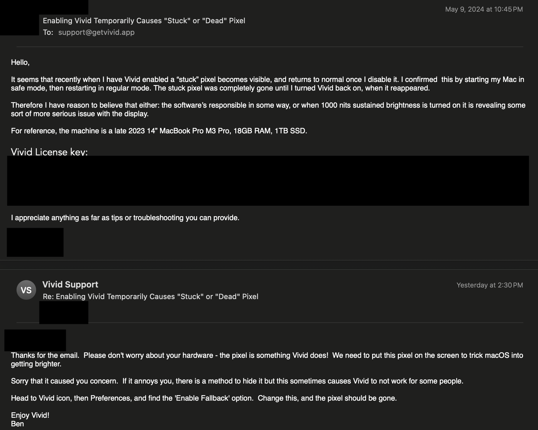

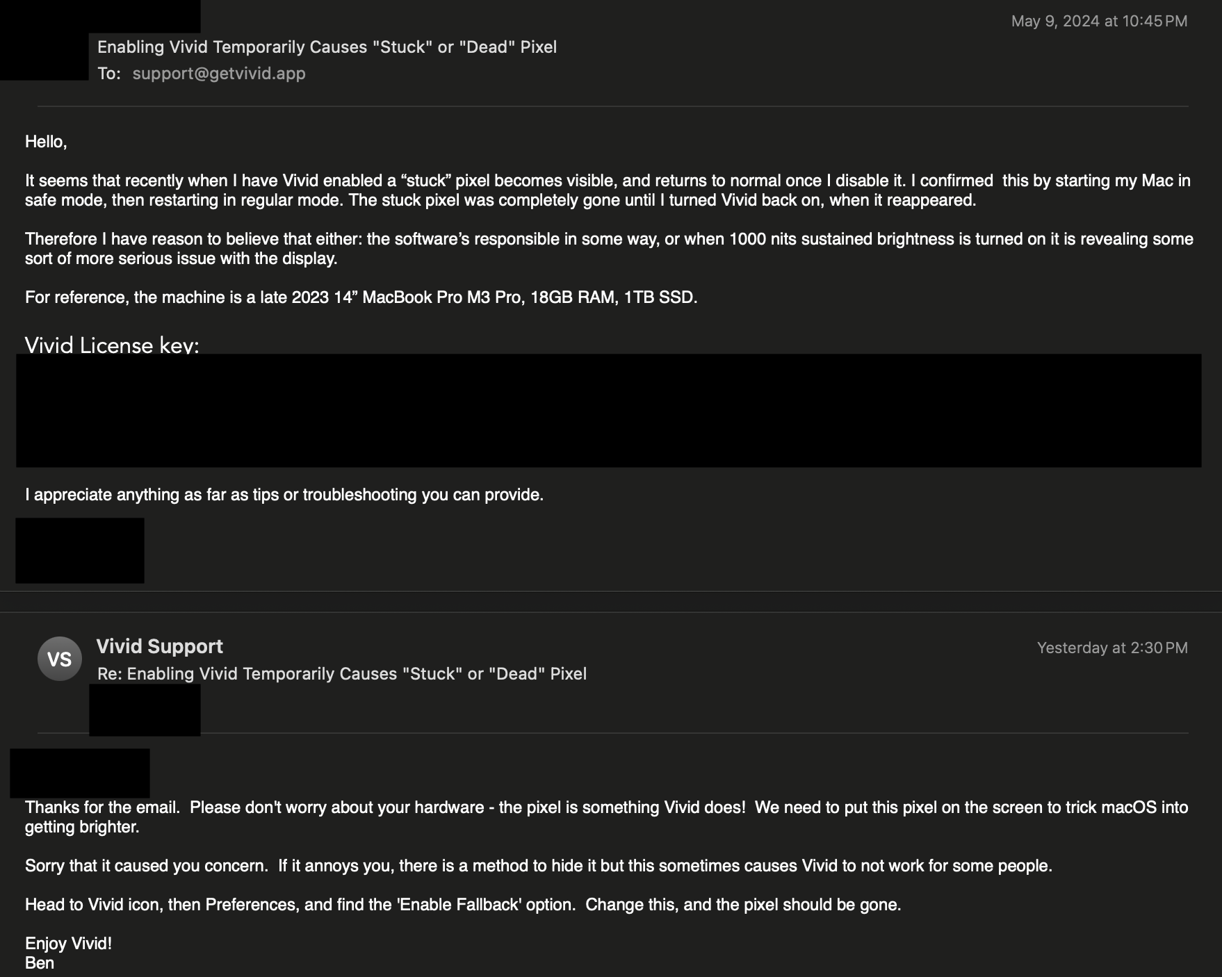

So I received a reply from the app developers and apparently they say the "hot" pixel is a feature not a bug! That's honestly fine with me—it’s not all that noticeable, and it’s worth the trade off of being able to make the screen brighter, especially for outdoor computer use.
So I received a reply from the app developers and apparently they say the "hot" pixel is a feature not a bug! That's honestly fine with me—it’s not all that noticeable, and it’s worth the trade off of being able to make the screen brighter, especially for outdoor computer use. View attachment 2377823
Hello, I ran into the same problem and deleted the app. Curious if you tried the "enable fallback" option mentioned in the support email. Any update would be appreciated
I haven’t tried it yet. The “hot” pixel doesn’t really bother me, and honestly I haven’t even used vivid in a while because I live in a cold climate, and haven’t had a desire to sit outside with my computer lately! 😅
But if I do I will be sure to add an update.
