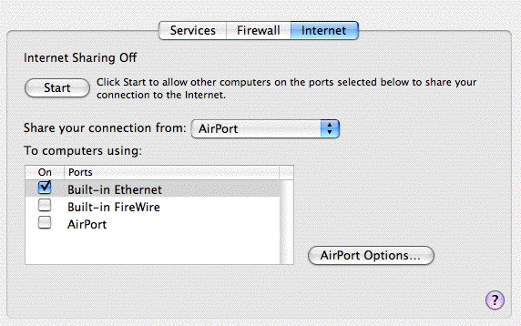

Would this work? Hotel only has a wireless connection. Could I download content to my macbook then directly connect my apple tv via ethernet from the back of the Apple tv to the ethernet port on my Macbook. Could I sync that way? Ive been researching this for hours but can't find out if that is possible or not. Thanks for all your help.
Ive done this before with a wired connection. I assume of works with wireless. Connect to the wireless network on your mac then share that connection (you'll have to google this, sharing airport connection or something). Then on your apple tv connect to the shared network and it should work

That should work, connect to the hotel's wireless from your laptop, go to "sharing" in your control panel and go over to "Internet" as in the attachment here (from 10.4.11) -- and you can then turn off wireless in your Apple TV. (You would press "start" ...)

I'm very confident this works. I can't remember if I could sync content from my mbp to my appletv by doing this, but I know I was able to stream content.

the answer to the original question is definitely yes. this is what i do at home whenever i sync new content.

Thanks all got my Apple TV in a few days ago and tested everything out using my home wireless network and it works well. Now the only question will be how good the wireless connection will be in my suite 😕

Doing Same Thing - ? On Connecting Apple TV to MacBookPro
So, following up, the plan for the washington stay was to:
1-Connect to hotel wireless via enable internet sharing on MBP
2-Connect to MBP via Ethernet Cable
3-Up & Running
? is this; don't you have to use cross over ethernet cabling in this situation; or set up a mini network using an ethernet hub?
I am confused by the choices in contro panel l of sharing via ethernet or airport...
Is the logic that as a unit, apple tv can connect to my laptop wirelessly, then out to the internet via laptop connection (no cable required)....or am I hard wired into laptop, via ethernet to Apple TV, sharing on ethernet connection my MBP connection to internet? And if I am connected directly to my MPB with an ethernet cable to Apple TV, I am pretty sure this requires a cross over cable?
