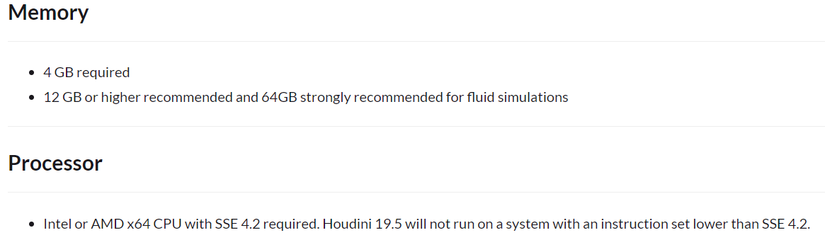

Has anyone here ever tried it with only 8gb of memory?
Looks like the requirements are such that its technically possible
It appears that the publisher states that the ARM processor is not supported, that may be the bigger nut to crack then the ram, but its not an application that I'm knowledgeable with. Others may have better advise then what I can offer.

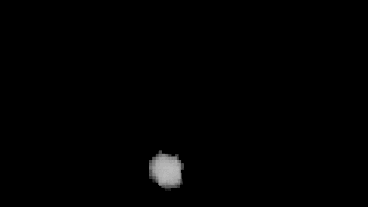

Longer answer: decided to actually give it a go rather than make something up. So was doing something like this (since it was not a million miles off the sword):
The basic low res setup was fine to work with; sim time was a few minutes, displayed fine in the viewport. Everything was ok. Can iterate pretty quickly. Happy days.
Increased the resolution to a level that would give something closer to a final result and things did not go well. The sim time increased to 20min. The laptop it didn't get too hot to touch but pretty sure the throttling added 3-4 minutes to the time.
The viewport interactivity also took a nosedive - 8GB was nowhere near enough memory to display the volume in a reasonable manner in the viewport. Making changes was fine, but the display was really slow and often beach balling.
