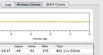

I decided to try "n" at 5GHz and holy wow it's fast. I'll post some screen shots of the Airport utility to show. I tried sending an .m4v movie file weighing in at 1.02 GB and it only took about three minutes. I think I'm going to try to use my airport express as the receiver for the "g" mode and leave the base station on 5GHz

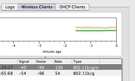

One interesting thing is that my MBP was getting 130 while my roommate's POS dell was getting 54 (as per "g") and my iPod touch was getting significantly less of course. I did not know that it could do multiple rates. It is important to note that this is not a dual band AEBS.

That is apple's Airport Utility. It's free on their website and it comes with their wireless devices, but it only works with apple products. To get to that screen select your Airport express, extreme, or Time Capsule and click "Manual Setup." It will give you the stats of your device like the channel, the serial number, MAC address and the number of wireless clients. Click on "Wireless Clients" and it will bring you to that screen. It shows log entries like when it rotates the CCMP group key and when it associates with devices and even shows why a device couldn't connect. It's really awesome.
