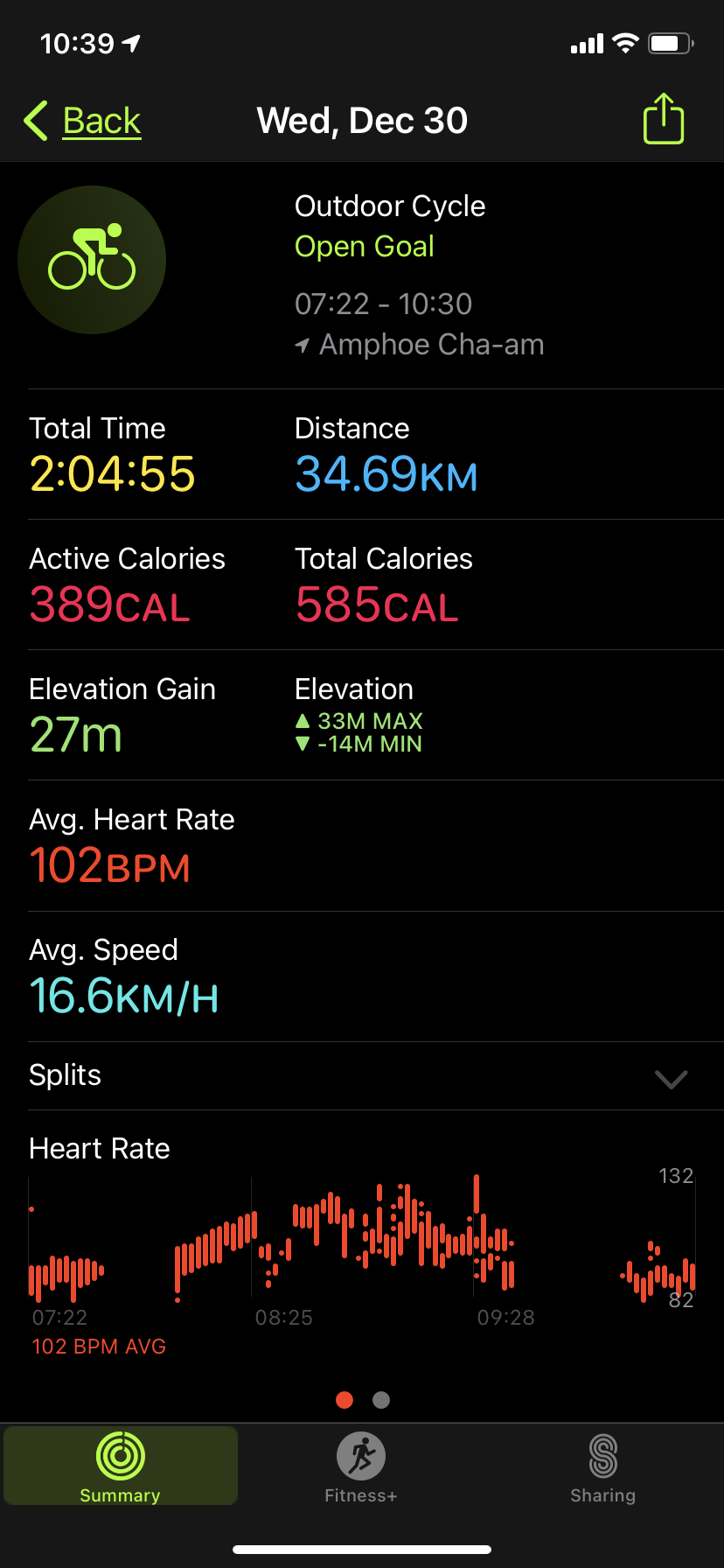

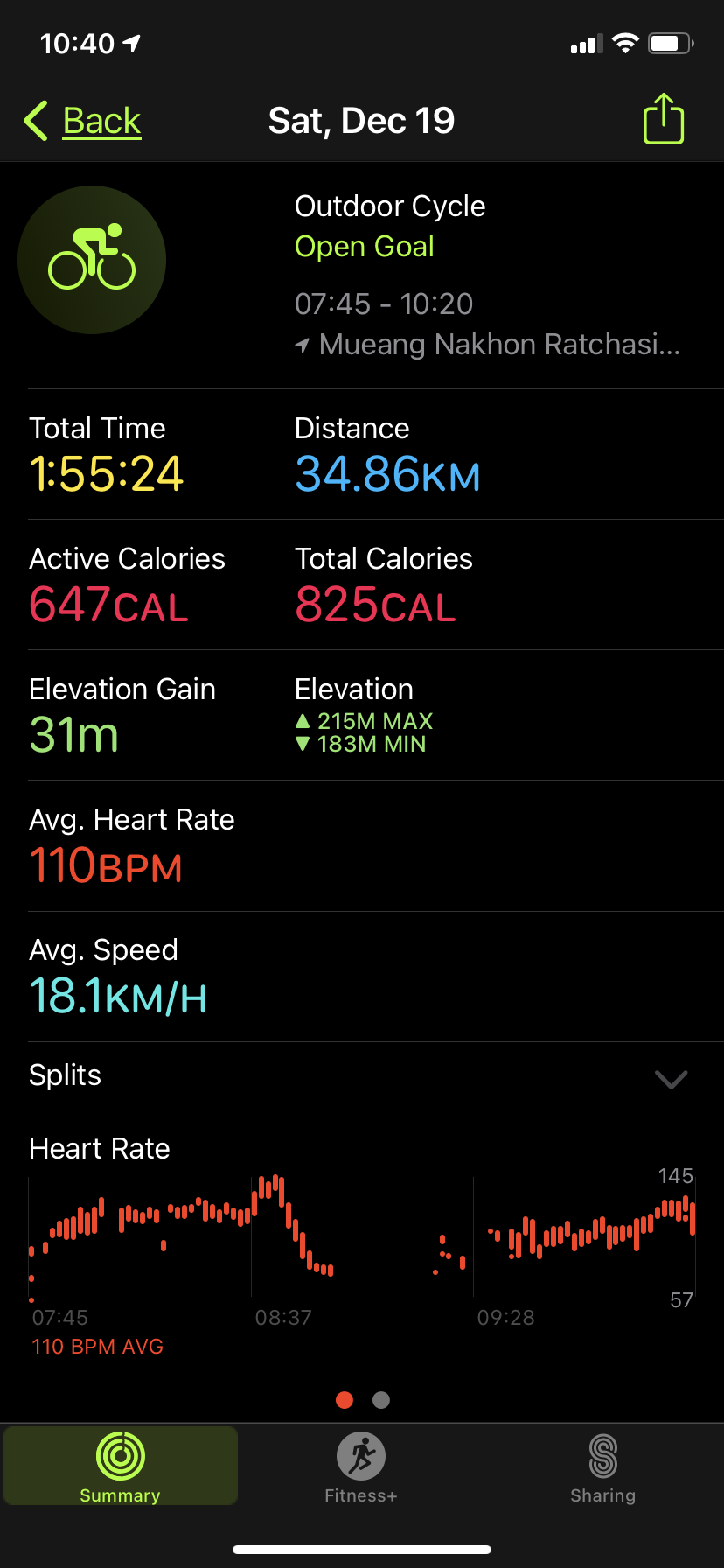

I find my Watch 6 to be wildly erratic when calculating Active Calories. Here are two similar cycling trips:
Yet one ride has 66% more Active Calories than the other. Granted, the heart rate and average speed are different, but not enough to account for an Active Calorie difference that great.
