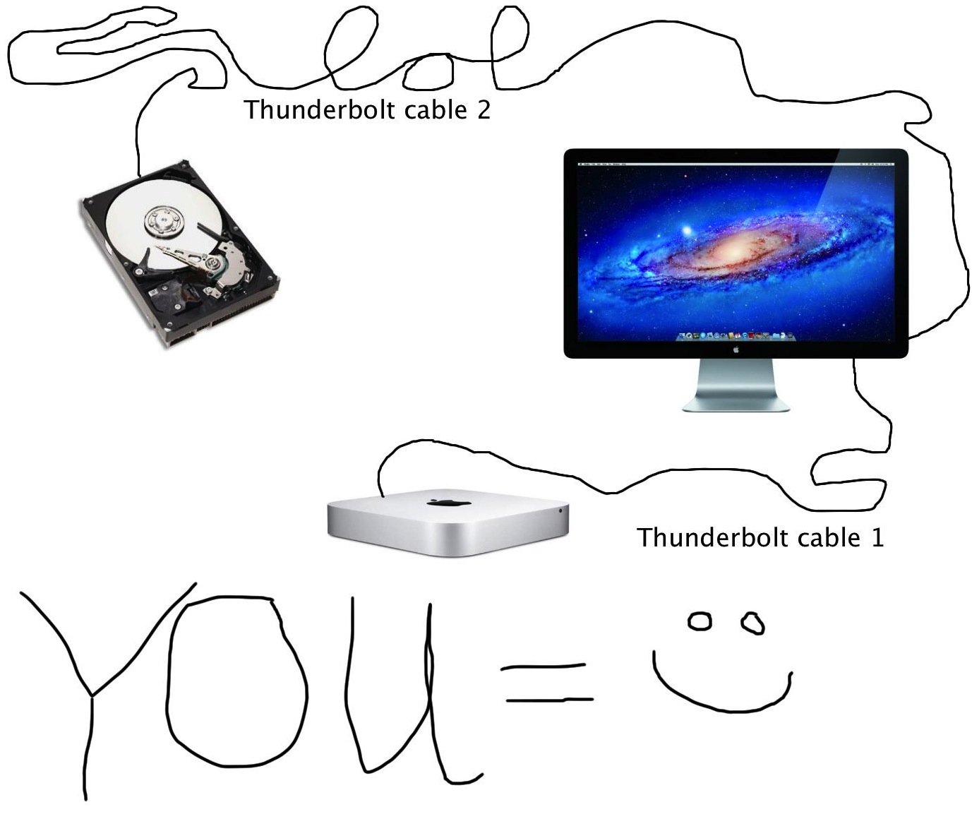

    #19
    Awesome thanx guys. I always thought i had to plug the thunderbolt cable into both ports mac mini and thunderbolt display. Since i didn't know it has an extra cable with magsafe. I thought that cable was just for mbp and mba.Btw wat about the ethernet port? Should i plug my ethernet cable into the thunderbolt display or straight to the mac mini?

  24. bungiefan89 macrumors 6502a
    Joined:
    Apr 5, 2011
    #24

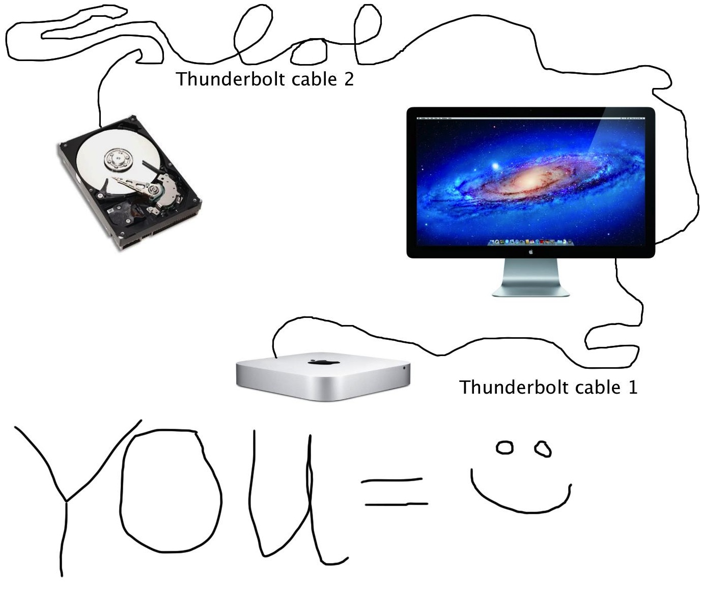

    Pictures time! :D
    OP, make your desktop look like THIS:
