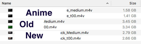

Sorry it took so long to reply.
So on BD there is a difference, which might not matter too most. But considering the difference is only sacrificing time I think its worth mentioning.
I used 3 different BD, an anime, and older movie probably remastered for BD and a new movie produced with BD in mind.
Settings were high profile only difference being medium speed and veryslow speed (t00).
These were all encoded at 1280x for so we're seeing ~5% which seems to translate to higher resolutions (1080p) making it even more significant. For my collection doing rough math is saving ~30gb (200 movies x 150mb each), with a collection encoded at 1080p it should be significantly higher albeit I haven't tested that.
EDIT: I'll try another BD at 1080p since I imagine that is what most people will be using.
BD 1080p medium vs veryslow (t00)
Definitely would recommend the veryslow option for BD if encoding at 1080p.
