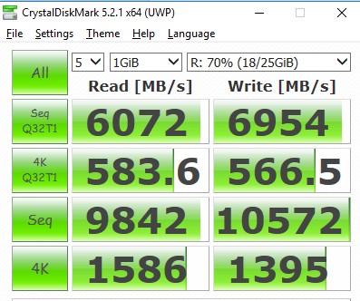

Mine had R/W speeds of 2100/700mbs before replacing with Samsung 970 EVO 500GB Nvme SSD, now 2950/2350, great improvement.

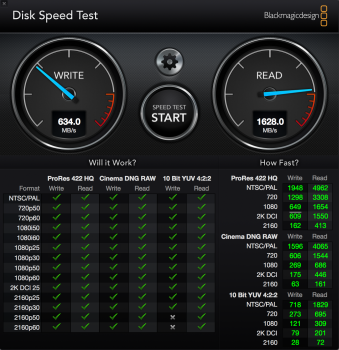

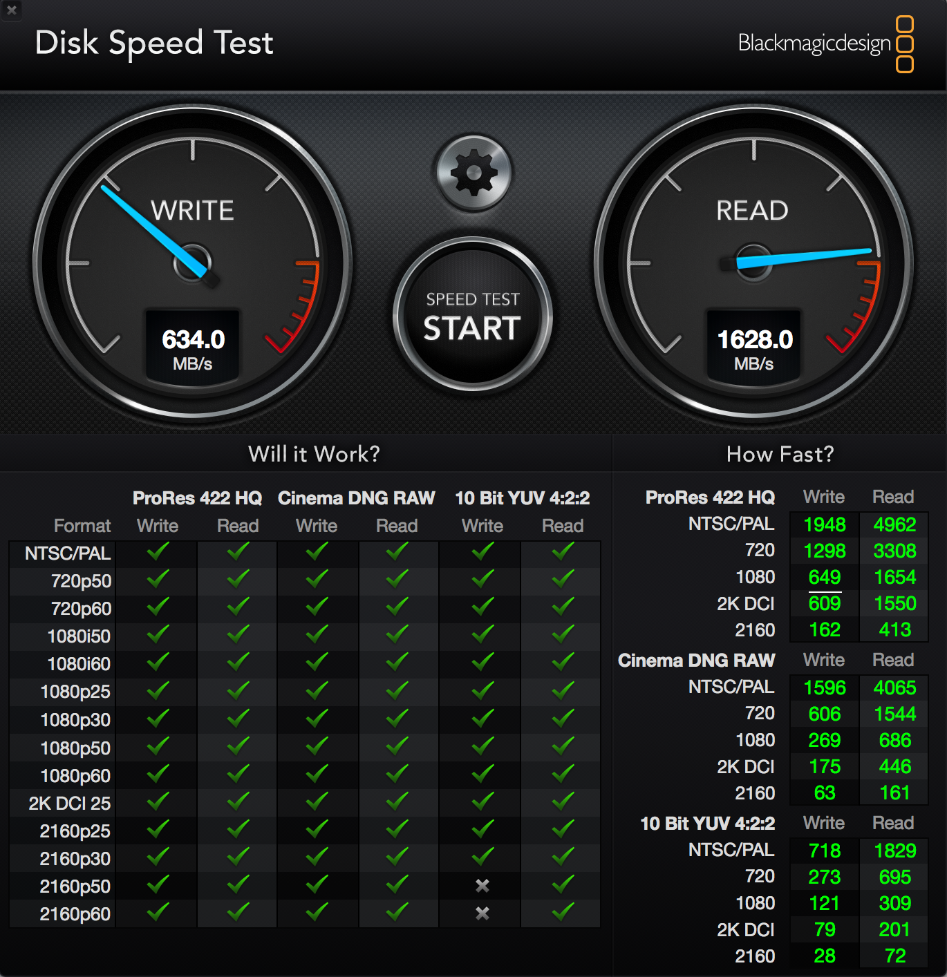

Yes, that was my thinking when I went and replaced the PCIe SSD blade, but others who replaced the HD for an SSD may be able to share their results.
It’s 600’s mb/sec plus writes and 1200 + reads. It’s faster then a external Samsung T5 that people rave over.
It’s 2TB of storage, it’s pretty darn smart and fast.
Edit it was 1600's read
That's running off of the SSD portion of the drive. The HDD portion of the drive will be far, far slower (likely in the neighborhood of 100 MB/sec reads and writes, with much higher latency and fewer IOPS). I think the idea is that the SSD portion of the drive is used for the OS / programs / frequently used stuff, and the HDD portion of the drive is used for large files and less frequently used stuff. I'm not sure how well the OS optimizes the SSD space, but if you use it all up and start loading programs / files / browsing images and stuff off the HDD, you will absolutely notice a significant difference.
