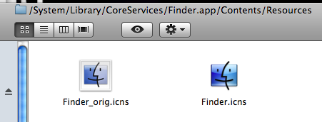

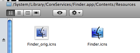

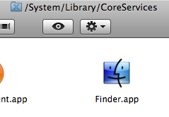

Aloha everyone,
I was trying to do the "free" thing to change the Finder icons. I renamed the original icon to "Finder_orig.icns" in /System/Library/CoreServices/Finder.app/Contents/Resources, then copied the replacement .icns file there. The new icon appears in the CoreServices folder, but the Dock still shows the original (see the attachments). Has anyone else attempted this, and if so, can you tell me where I'm going wrong? Does the icon have to be a specific size?
Mahalo in advance for your responses,
HawaiiMacAddict

Aloha again ergdegdeg,
I just tried it and everything is A-OK now! Thanks again for the reminder. I don't understand what that app does that I did not, however. I replaced the icon and killall'd both the Finder and the Dock, so I should have completed the same steps as the app. Oh well, at least I can change the icons to my liking 😀
HawaiiMacAddict
