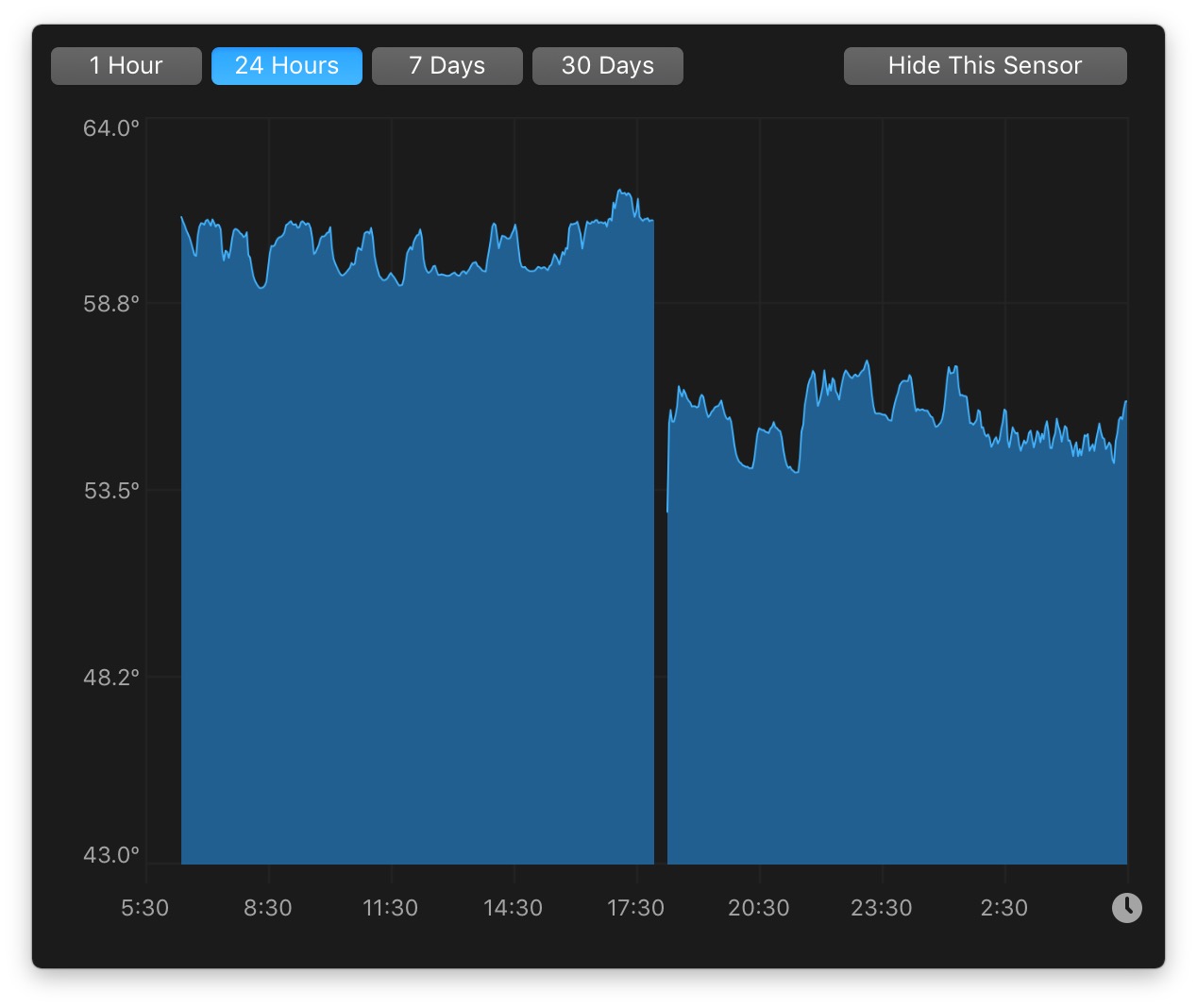

Coincidentally, I also just clean my cMP today. I have to do that about every 2 weeks (Hong Kong is a very dusty place), and the temperature drop is very obvious.

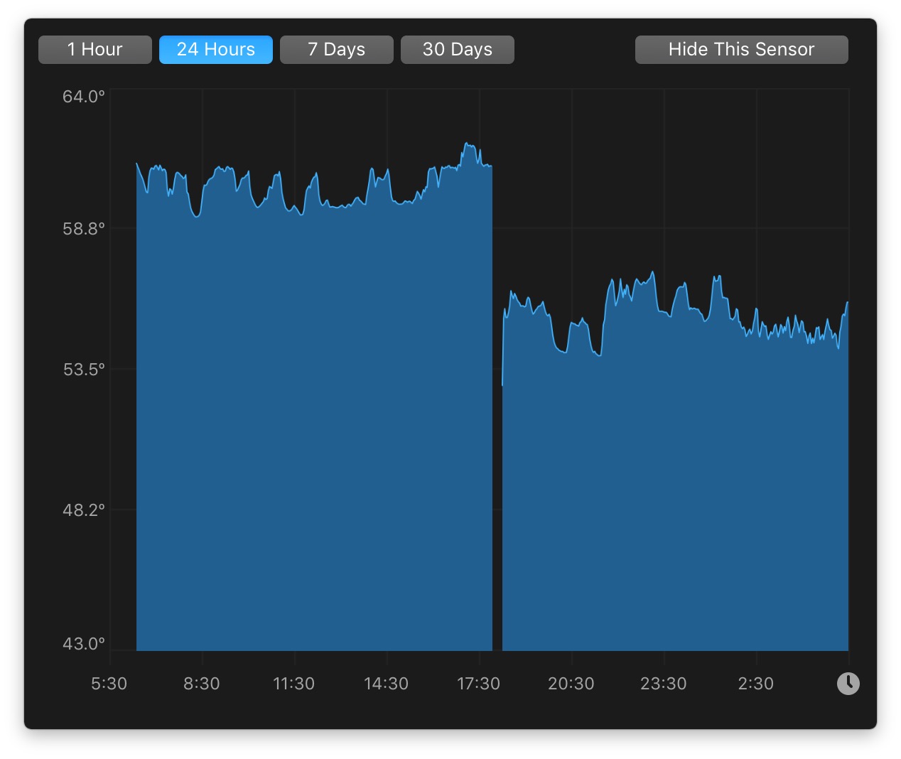

Wowza! That graph really brings home how important a good spring cleaning is! Just don't tell your mother she was right all these years... ;)
