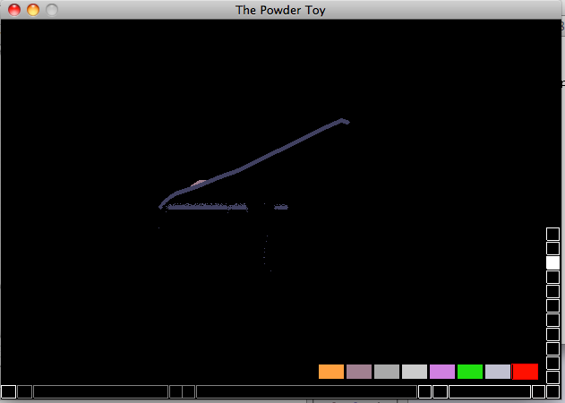

Hmm, it compiled, except not into an app, it's still a 'unix executable file' and it's really wonky compared to the one when you do 'make powder-x'.
here is a pic:
Doing make powder-x-gui instead of make powder-x should return an normal MacOS application.
