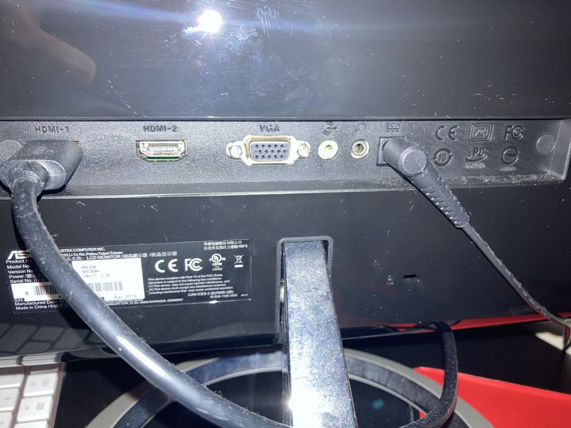

Thank you for the quick reply.
Just looked in the back and see it says VGA.
I used to purchase numerous cheap third party adapters many years ago and learned my lesson after spending/wasting so many dollars. I now usually stick to either Apple or Anker among a few others.
My current Asus monitor is right next to my Mac Mini but the TV w/ HDMI will be about 15 feet away. I’ll primarily be moving Netflix and YouTube onto that TV screen 99% of the time.
You do not want to use VGA. VGA is an old analogue connection. If it just has VGA and HDMI, stick to HDMI.
Another option for that type of content is to AirPlay from your Mac Mini to the TV - a lot of TVs support AirPlay natively or you might have an AppleTV or something to target it to. That’s a no cable solution.
Otherwise yeah you want just any USB-C/Thunderbolt -> HDMI adapter/cable that isn’t a non-standard-conforming bit of junk :p
