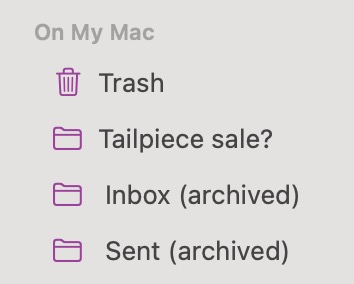

You need to make sure that all the email you want to save is in folders created using the "on my Mac" option. (see note at end of this reply)
Doing this ensures that the actual emails will be in those folders. Like this:

Navigate to your "Mail" folder -- it's here:
home/library/Mail

Why your old emails need to be in the "on my Mac" area...
If your emails are still on your ISP/email provider's server right now, when that server shuts down, those emails could vanish. Either immediately or over time.
The way to ensure that YOU "have them" is to move them into folders in the "on my Mac" area. When you do this, Mail.app will go to the server, and copy the body of the email AND any attachments.
Remember that (at least with IMAP) when you look at the list of emails in Mail.app, what you're seeing are "the headers". The actual body of the emails may not be on your Mac... just the headers. If they are removed from the server, they'll disappear on your Mac, as well.
So... that's why you need to "grab them" and force an actual "copy" onto your drive...
