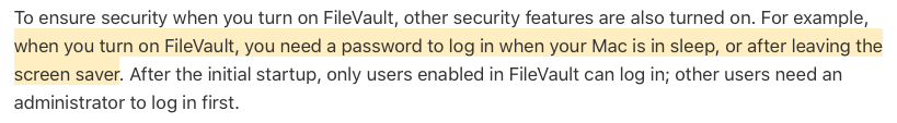

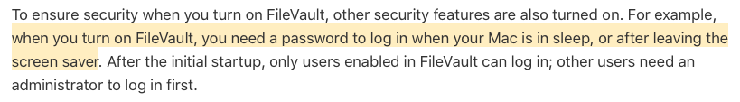

Do you have FileVault turned on?
Blur muddies things up with:
"Do you have FileVault turned on?"
No.
I've never used Filevault on the Mac, not once, ever.
No interest in it.
