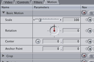

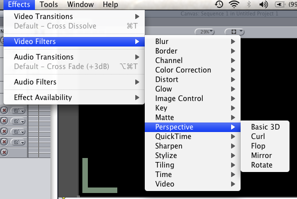

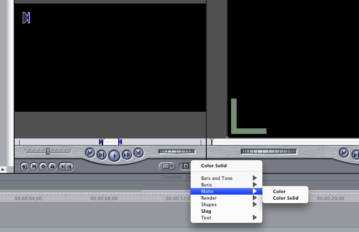

Since you have Final Cut Express 4, you can do this. I'm assuming you know how to use FCE 4.
1. On the first Video track, create a black matte (for the black background
2. Add your 1st video clip on Video Track 2
3. Go to the Motions tab and scale it down, then add a BASIC 3-D Effect (and mess with it.)
4. Repeat for the 2nd video clip
5. Mess with each clip's Motion setting for alignment (centering), and scaling.
I just did it as a test in under 3 minutes. It's very straight-forward, but if you're unsure about some steps let me know!!!
See pics for some clarification.

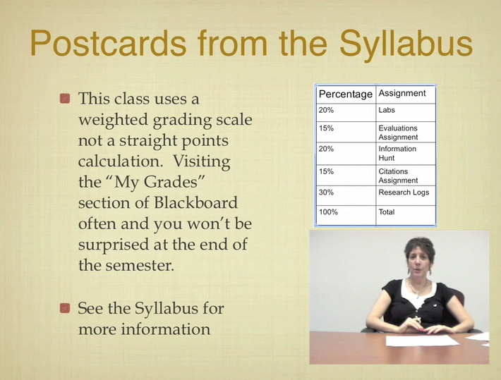

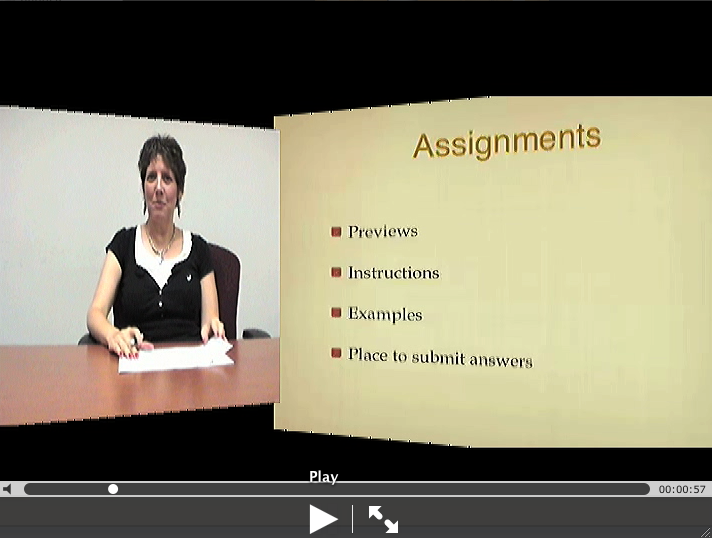

This was really helpful. I'm very new to FCE and iMovie to be honest. My experience with video has really been with re-encoding.
I managed to get the perspective right, but it just looks aweful. Here is a screen shot. The file ended up being 1.5gb for 6 minutes... 😱
It just doesn't look quite as good as the Apple Produced one. I can't really figure out what I did wrong.

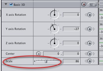

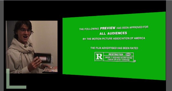

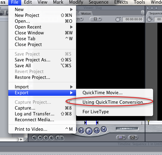

You got the idea right but you just need to tweak it.
First, I would crop the left-hand-side video on its right side a bit.
And since your right hand side video seems like its top/bottom are chopped off, try scaling it within the Basic 3-D filter (shown in the picture below).
Also, I put my test picture of this effect below too.
Lastly, you can re-encode the file to be smaller. Go to EXPORT - and use AS QUICKTIME CONVERSION. Then find an appropriate codec. H.264 is a good one that makes the file size very small and maintains decent image quality (not the best, but it's good).
