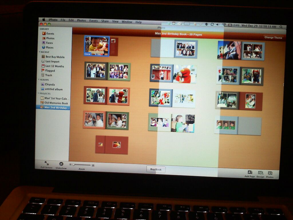

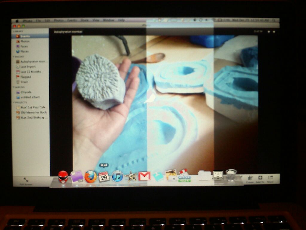

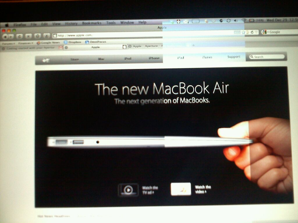

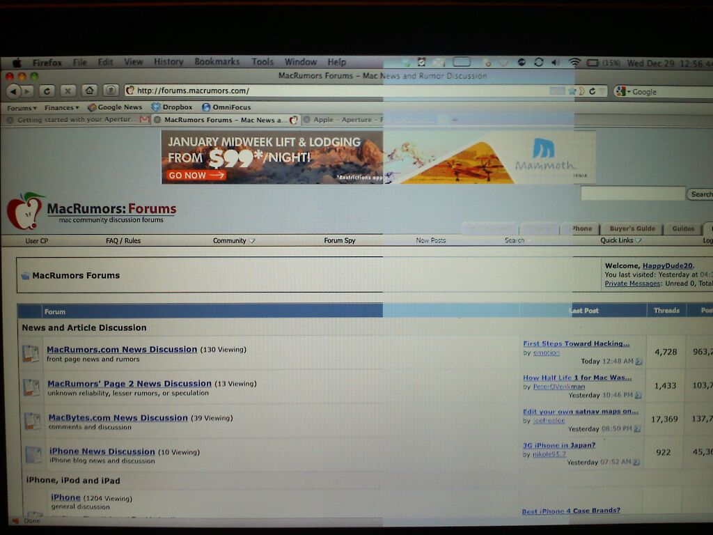

For about 2 weeks now my MBP (13 inch) has been messing up on the screen area. More times than not this oddly messed up, lit pane on the screen comes up and remains at all times.
I've tried moving the screen up and down (like, lowering its position to almost a close) but no luck at all.
About a week ago I searched on IFixIt to see how to fix the LCD screen and discovered I could take apart most of the MBP, including separating the bottom half (keyboard) from the screen portion of the overall MBP.
Nevertheless reached the cable that connects the screen itself to the logic board......but figured i'd ask here, assuming and hoping someone can steer me in a positive direction.
(Yes, I have AppleCare, but have taken my MBP apart so many times I'd rather do this myself considering if I send it in to Apple, they'd most likely notice my modifications inside)

As it seems to be happening on a variety of screens, and still appears after a reset I would say (in my sleepy Wednesday morning state) that its either going to be a problem with the logic board or the connection to the logic board.
My answer. Take it back to an Apple Store. What 'mods' have you done?
Have you tried simple SMC and PRAM resets?
Yes I have and upon the screen turning on after startup the same thing on the screen appears.
I know I haven't spilled anything inside of the machine and will most likely place blame on the connection to the logic board/lcd screen.

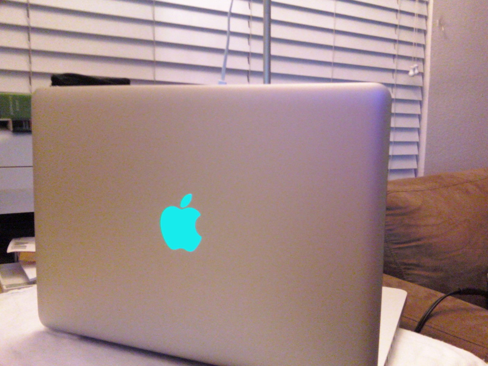

Really, it's one mod, where I sanded the apple logo from the inside with sandpaper so I could place a purple color filter inside so my MBP's apple logo would be purple. Admittedly, though getting a lot of compliments, it's not worth the mental trouble of having a messed up screen.
I'd say its on the cable and the connection itself. This exact part in fact:
http://www.ifixit.com/Guide/Repair/Installing-MacBook-Pro-13-Inch-Unibody-Mid-2009-LCD/1423/11
Everything seems fine on the macbook pro, including the connecting parts I just linked to. It just seems that perhaps its not secured right, or not secured tightly enough....
..and it makes sense too. Considering on numerous I would take the glass bezel off my MBP to access the apple logo from behind to add or remove the purple color filter before taking it to the apple store.
Do a screenshot, look at it on an external monitor or something. If the bright field is gone, I'd say it's a display issue.

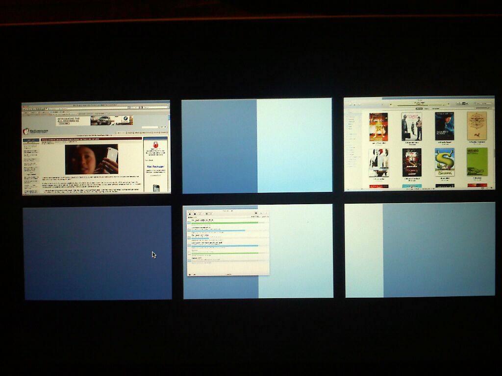

Just did a few screenshots, emailed them to myself and viewed them on the iPad without any issues.....
It's def. the screen on the MBP itself.

Update - It Works Now!
So I decided to take apart my MBP again tonight.
I completely took it apart and after 40 minutes of channeling towards the LCD screen and the cable, I noticed the cable, or rather where the LCD & cable connect was dinged/messed up a little bit. But I decided to still forcefully, gently connect it once again and success.
My screen now works perfectly as new. Though its been only an hour so far and am gonna be on edge for the next week in case it comes back. If so, i'll hand it over to AppleCare.
