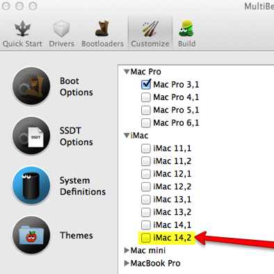

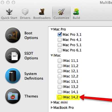

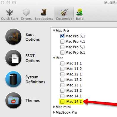

That would be a MacPro3,1 just change it in your config.plist. It is simple to do and does not much matter but will fit your system as it should be. It only had a 4771 as it best processor, but it so close to your model that is what you should use. I had a i5-4670 in mine a perfect match to what was in a 14,2.

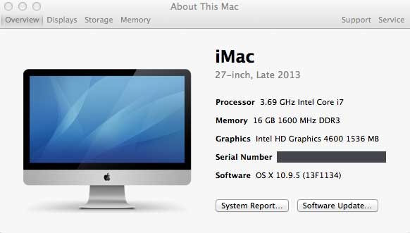

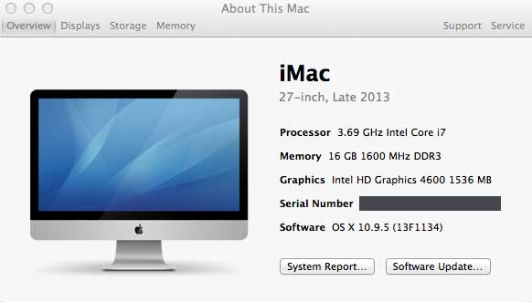

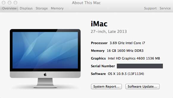

MacPro3,1 correct. I have just changed this in Multibeast v6.5.1 (1) which is a 2014 version. I selected iMac 14,2 which looked like the highest spec of iMac I could choose.
It worked, my machine is now iMac 14,2
