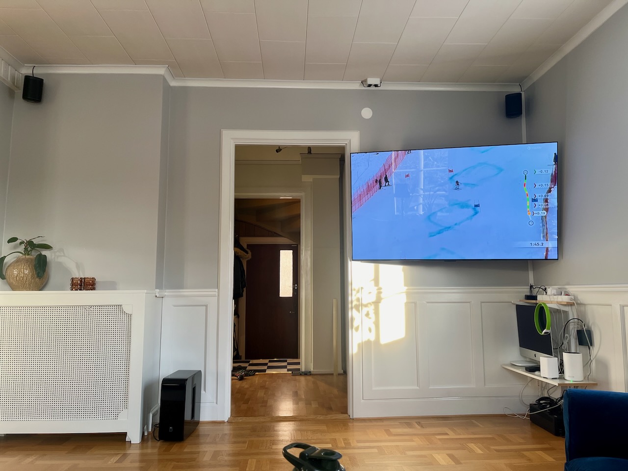

In the living room I have:
- 2 Sonos One, set up as a pair. Connected to the router with ethernet cable.
- 1 Sonos Sub, paired to the Sonos One pair.
- Apple TV 4K, connected to the router with ethernet cable. I have choosen the Sonos as sound output, but I can't set it as default, only temporary.
- LG C3, connected with HDMI to the Apple TV.
Since I got the TV earlier today it's been steady. However, it probably won't take many days until there is no sound and I have to manually enter one of the audio menus to choose the Sonos as speakers. It's irritating but managable when that happens to me, but when my wife or daughter get this bug, they don't know what to do.

The thing is, our living room with the TV area isn't directly suited for a home cinema experience. Look at the picture (ignore my tech corner to the right 😝) – Would it still be advisable to buy a Sonos Arc? The width under the TV is 130 cm wide (≈ 51 inches), while the Arc is 114 cm. Is it too narrow to give a nice sound experience?
I am ready to do that investment, but I'd like to know if its advisable.

Would you be mounting it under the TV? Or would it be sitting on the corner tech shelf ;-)
Assuming mounted, since you bring up the measurements... my guess is you'd lose a little bit through the doorway on the left of the TV unless the door is closed. If it's open, audibly, you might notice a stronger sound presence coming from the right side, since that side has walls to bounce the sound off of. It probably won't be too terribly unbalanced, especially if you're seated on the left side of the couch/TV, but likely so for the person in the blue chair on the right. But then again, the Arc may be different than the Beam in that regard. See below.
Our room was much more open on the left (no wall to the kitchen) than on the right (the wall/doorway of our bedroom), which gave the Sonos Beam we had nothing to bounce off of at the left. The sound was completely unbalanced and really made an awful experience.
