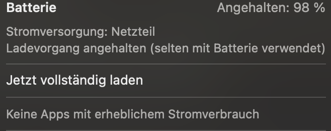

Nice it now tells that charging stopped:
