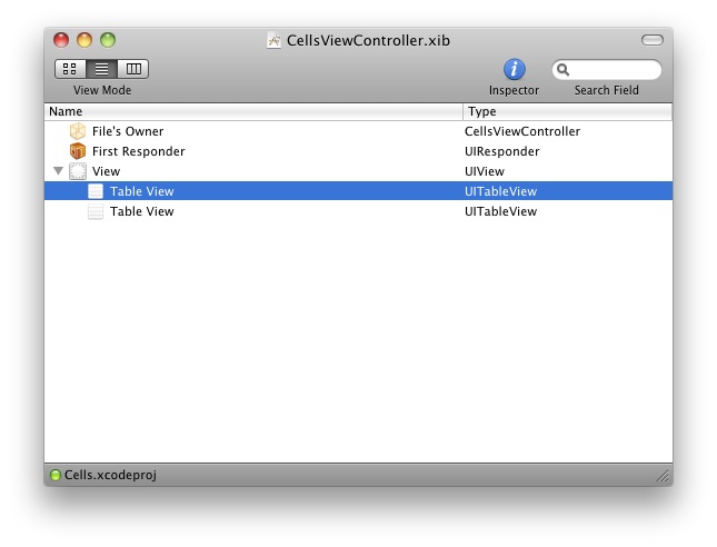

I have two TableView in a TableViewController as below, how can I know which TableView in cellForRowAtIndexPath?

The first parameter to the method is a pointe to the table view calling the method. Compare this pointer with the IBOutlet pointer you have to the tables you created in IB. If you do not have outlets linked to the two table views create some.

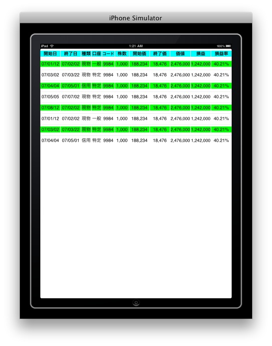

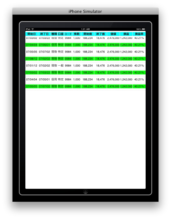

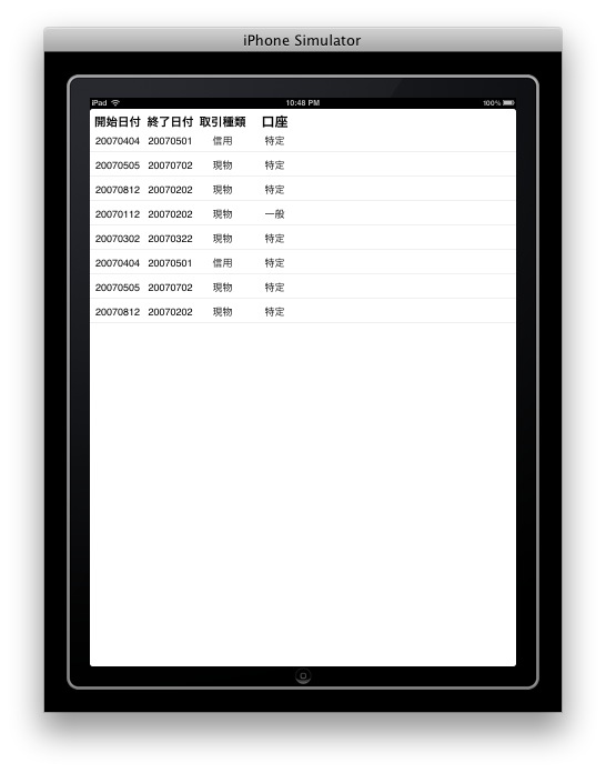

I want to the top tableview only show one row for header, bottom tableview for detail rows and scrollable.

Well, I have three class, CellsAppDelegate, CellsViewController and CustomCell, can you tell me where I can define outlet?
You need access to the outlet to compare with the parameter passed to tableView:cellForRowAtIndexPath: so I would suggest that if the instance that this is defined in is in the xib then in there. Otherwise in your controller class and pass the pointer where it is needed.
Thanks for your advise, now I got what I need.

You will see My Table view has a fixed header.
