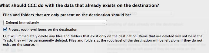

It says the following:
What should I do for this?
That check box is set so that you don't delete root level stuff, i.e., /
If its a fresh drive, it doesn't matter, for my cloning I delete everything off the destination so that checkbox is cleared.
I ended up choosing don't delete, dammit, my bad.
I chose it because it had already partitioned to create the recovery part of the hard drive so I didn't want to reverse that.
Oh well, I'm sure it will work 🙂 If not I'll do it again keeping delete everything selected.
This SSD was brand new and I had just formatted it as GUID and extended journaled so I'm surprised that option wasn't greyed out for me as well.
I'd uncheck that, since you don't want any leftover junk on the SSD. You only want the original HDD contents on the SSD.

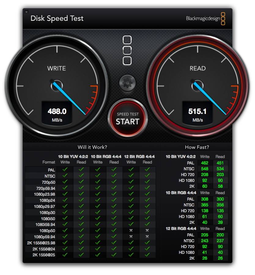

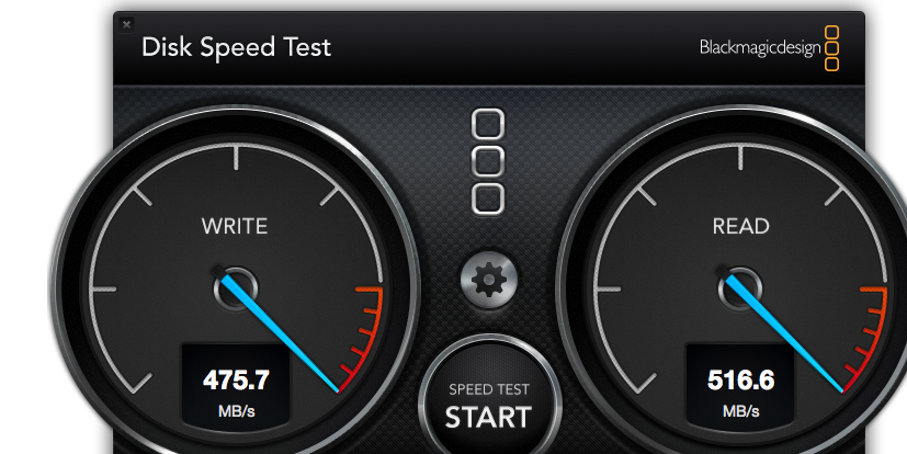

Speedtest before update (fw update should improve it)
This thing is blazing fast. I just shut down with stuff open from the desktop in less then 3 seconds, booted in 10 -_-

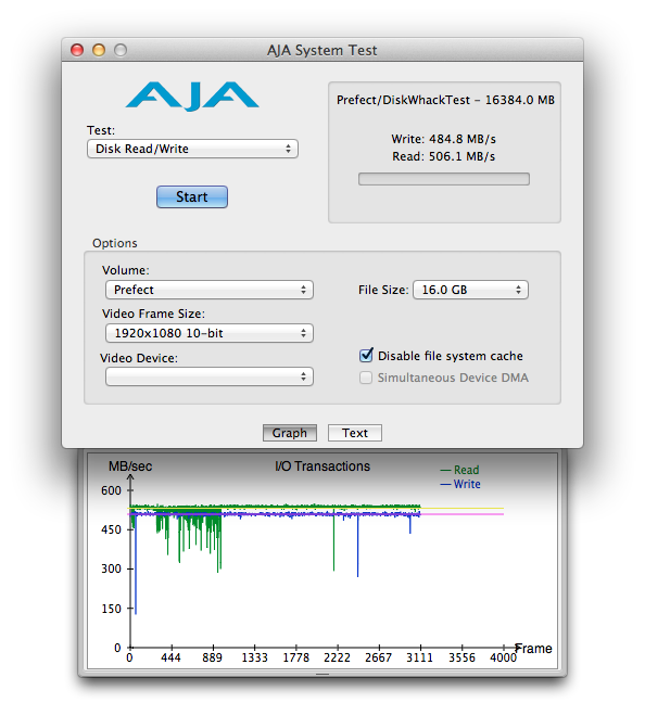

My speeds are about the same on DXM04B0Q firmware, but mine didn't need updating, as it was already this latest one.

One question: How did you speed test using AJA? It doesn't let me select the volume to test. I just looked it up and somewhere it said you cannot test boot drives? How did you do this?
