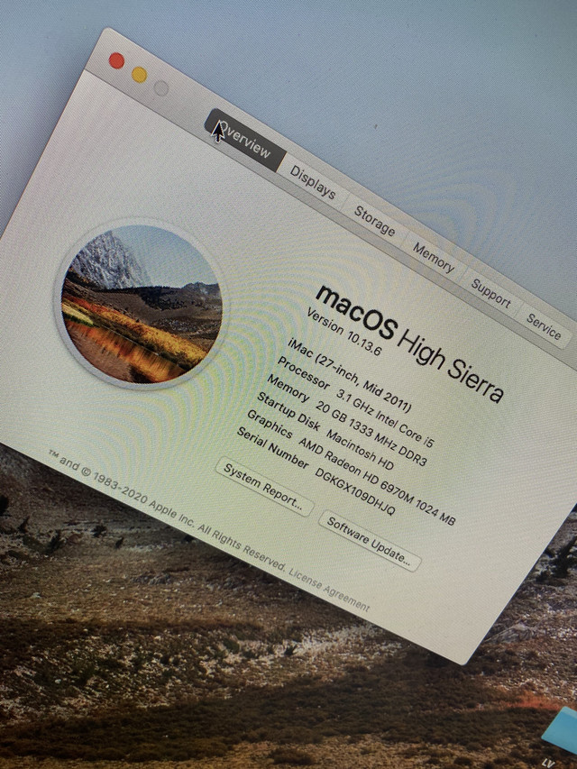

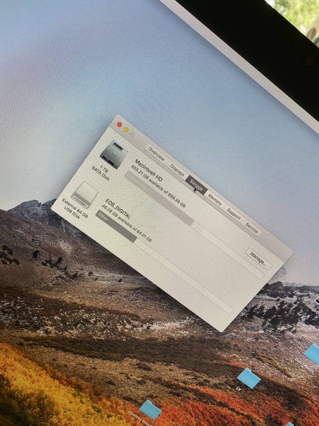

Hi guys,
It seems quite slow, I’ve updated it.
Anything I can buy to make it faster?
Thanks
Outside of buying fast hamsters and a SSD to run the OS externally, I can’t think of anything more practical.
Why didn’t you take a screen shot of your Mac, instead of taking pictures at such a bad angle?

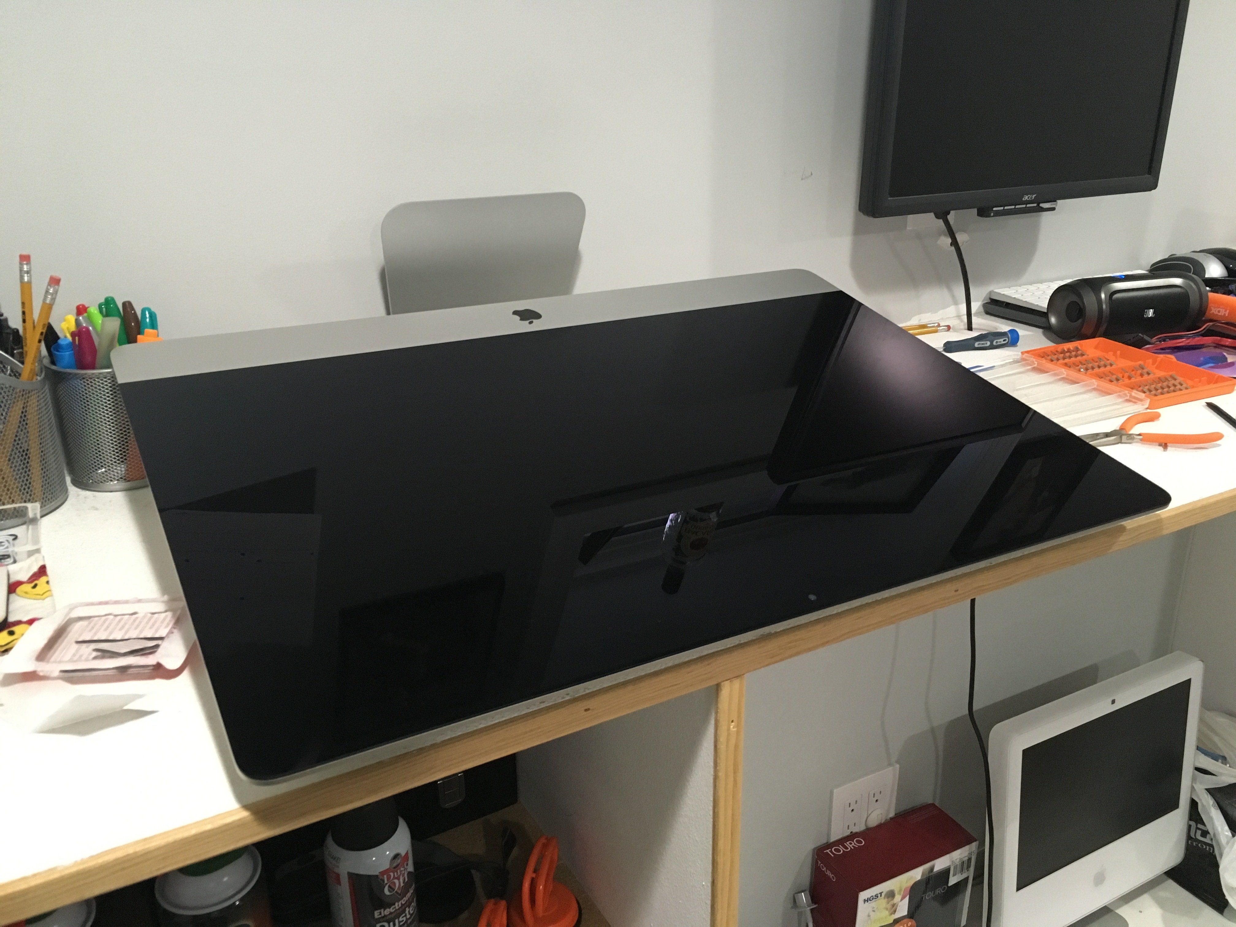

Here's the iFixit guide that works for the 2015-2017-2019 versions. Note: You don't have to have temp sensor attached to the drive as some people might claim. The iMac uses the drives' smart sensors to determine fan speed.
