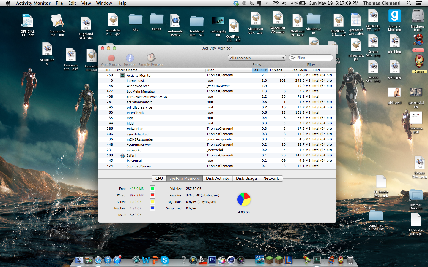

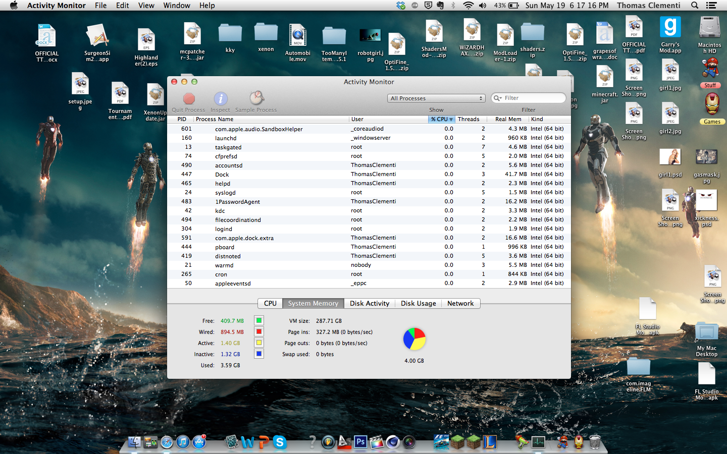

Screenshots-Please help my mac has gotten extremely slower over the past few weeks.
Please Help.
Thanks,
Tclementi1

One thing I see is you have both Avast and Sophos antivirus apps installed. First, it is never recommended that you run more than one antivirus app, even on Windows, as they can conflict with each other and cause false postive readings. Second, I recommend that you avoid using Sophos, as it could actually increase your Mac's vulnerability, as described here and here.
Finally, Macs are not immune to malware, but no true viruses exist in the wild that can run on Mac OS X, and there never have been any since it was released over 10 years ago. The only malware in the wild that can affect Mac OS X is a handful of trojans, which can be easily avoided by practicing safe computing (see below). Also, Mac OS X 10.6 and later versions have anti-malware protection built in, further reducing the need for 3rd party antivirus apps.
Read the link below for tips on practicing safe computing, which is all you need to keep your Mac malware-free.

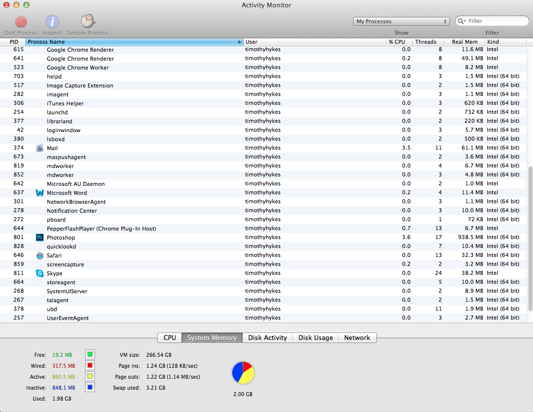

performanice issues
I've been having performance issues with my Macbook Pro. I'm a graphic designer/developer and I couldn't afford to buy a new macbook pro since i'm a student and all but... once I start designing and developing my mac moves so slow really slow. I just powered my mac up this morning and here are the images... Do I need more memory or what? Thanks in advance for the help.
My System
MacBook Pro
15-inch Early 2008
Processor 2.4 GHz Intel Core 2 Duo
Memory 2 GB 667 MHz DDR2 SDRAM
Graphics NVIDIA GeForce 8600M GT 256 MB
Software OS X 10.8.4 (12E55)

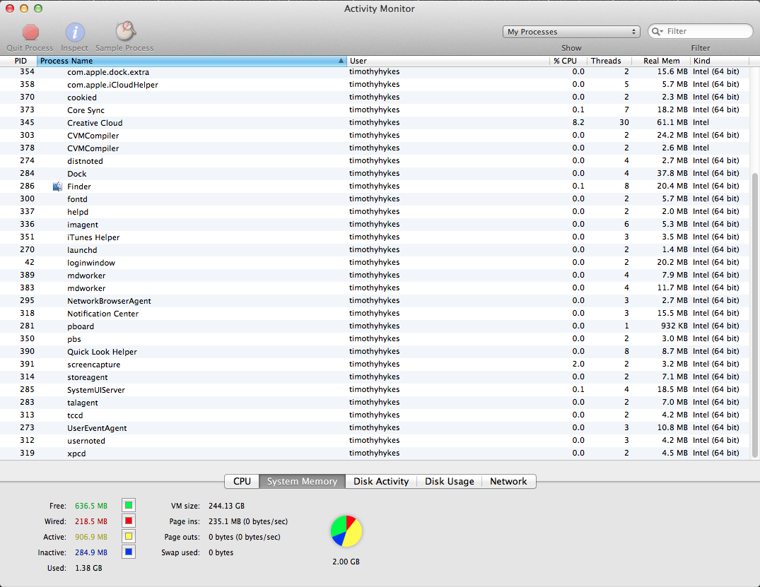

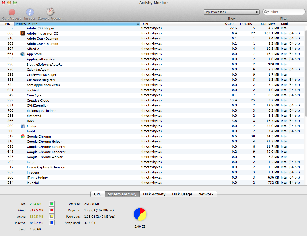

It looks like you might benefit from an increase in RAM. Read the first link in post #2 and read post #17 in this thread.
Ok, So I restarted and its 0 pages. So when I start to develop and design my issues is running to many programs at one time. Which is using up a lot of ram. Would I still benefit from an upgrade or will the be to much for the system to handle.
If you are routinely getting page outs during normal operation, you would probably benefit from more RAM. Your MacBook Pro can take up to 6GB of RAM, which would help with running multiple apps simultaneously.

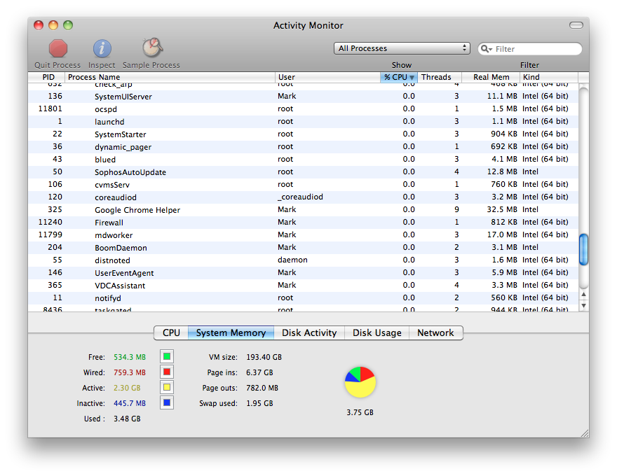

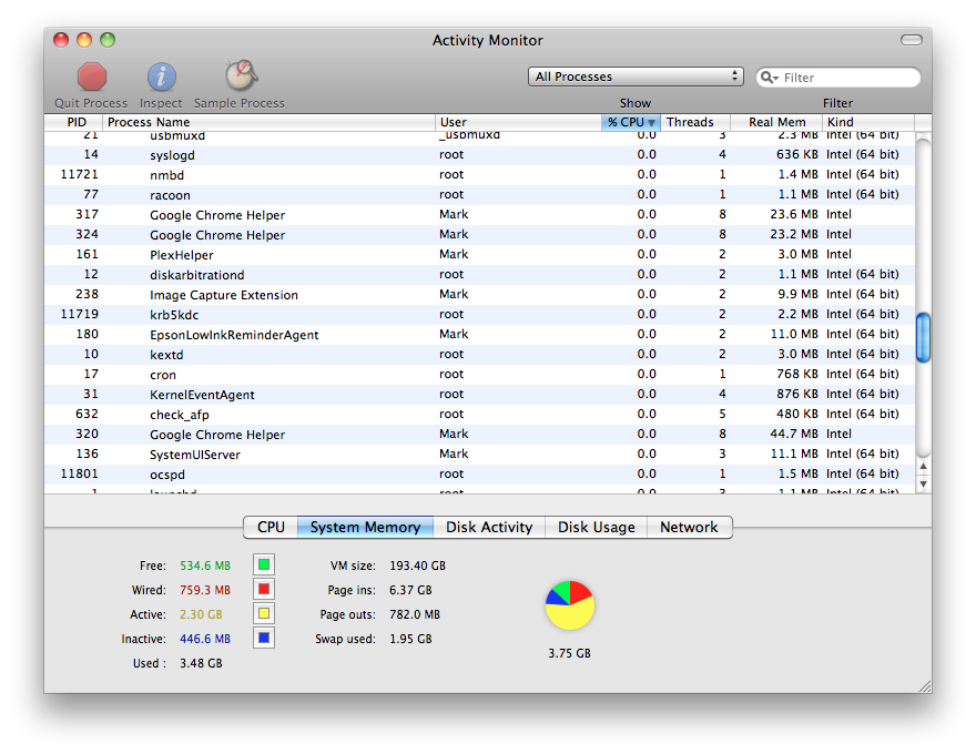

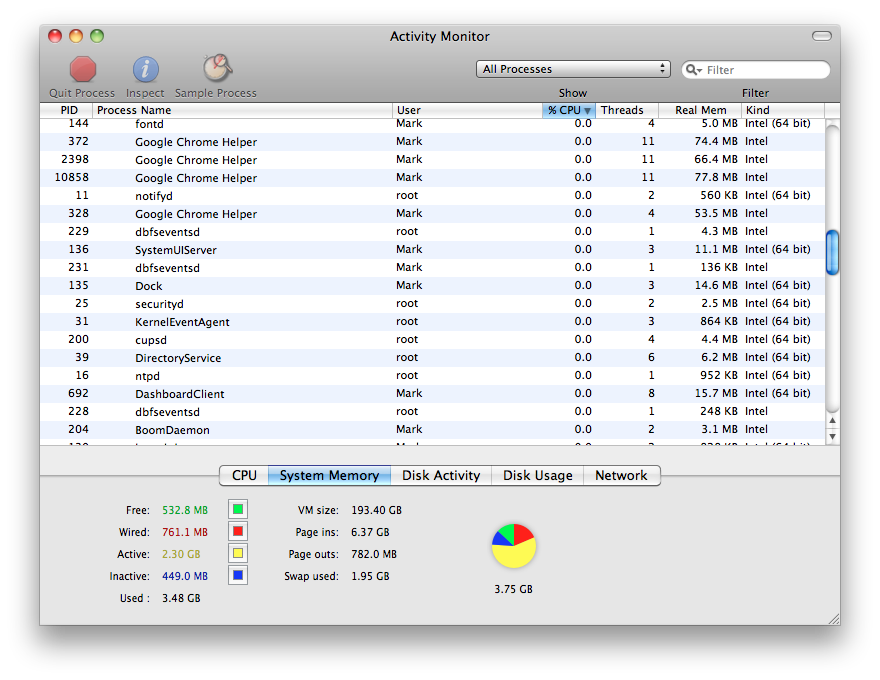

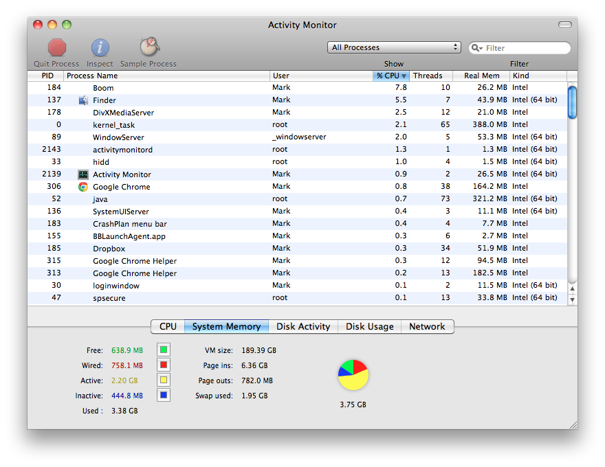

I would appreciate any feedback on my mid 2010 MacBook Pro, which has begun running sluggishly in recent months. I presume bumping my RAM would help, especially based on the page in/outs (I last restarted less than 24 hours ago) but before I do want to be sure I am not unintentionally allowing other stuff to significantly bog down performance, especially since my normal usage is just internet & email stuff. Seems like I shouldn't need tons of RAM for that. In particular, what is all the resources for Google Chrome Helper? It doesn't show in the screen grabs, but one of those were sporadically showing %CPU between 20% and 30%, just while sitting idle!
Also, I have about 90GB free on my 250 GB HD.
Here are my CORRECTED screen grabs. 😱 Thanks for any help!

Follow the instructions in the 2nd post of this thread (especially steps 2 and 3), then re-post your new screen shots.
I've edited my original post to include the corrected screen grabs. Sorry for the error - hard for these old middle aged eyes to read I guess! 😱
Appreciate your time and help!
EDIT: Also just figured out that I had 7.7 GB of space dedicated to Chrome as I wasn't aware that previous versions were retained! Unbelievable! Just reclaimed all over 7.6 GB of space by deleting the old versions. Perhaps that stupid oversight contributed to the multiple incidents of Chrome Helper showing up in the Activity Monitor?

First, I recommend avoiding Sophos, as it can actually increase a Mac's vulnerability, as described here and here. 3rd party antivirus apps are not needed to keep a Mac malware-free, as long as the user practices safe computing, as described in the following link. If anyone insists on running antivirus for some reason, ClamXav (which is free) is one of the best choices, since it isn't a resource hog, detects both Mac and Windows malware and doesn't run with elevated privileges.
Also, I'm not sure what you're using Net Nanny for, but it's likely unnecessary, unless you have kids using the computer.
Boom seems to be using more CPU than it should. Make sure you're using the most current version. You might consider uninstalling/reinstalling it.
If you're looking to free up some space, this may help:Freeing up drive space in Mac OS X
Thanks. I have been reading some negative reports about Sophos and will likely delete that. I may need to replace it with clamXav, as I have two teenagers who use this laptop, so despite my repeated 'safe computing' lectures I cannot be confident that websites and files that should be avoided actually are avoided. Hence the presence of Net Nanny as well. Hopefully the day will come soon when I do not need such measures, but that day is not now.
I'm using the most recent version of Boom, buty I'm also debating removing it, as my research shows its a known CPU hog. However, it is probably a cost I am willing to accept, as I have significant hearing issues, so I will likely keep anyway.
Do the page in/outs suggest to you a RAM upgrade would significantly improve performance?
To determine if you can benefit from more RAM, launch Activity Monitor and click the System Memory tab at the bottom to check your page outs. Page outs are cumulative since your last restart, so the best way to check is to restart your computer and track page outs under your normal workload (the apps, browser pages and documents you normally would have open). If your page outs are significant (say 1GB or more) under normal use, you may benefit from more RAM. If your page outs are zero or very low during normal use, you probably won't see any performance improvement from adding RAM.
