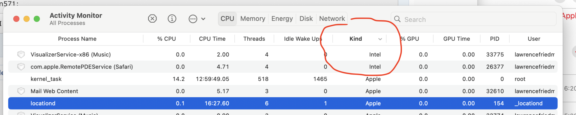

Open Activity Monitor and if you see Kind:Intel, Rosetta is already installed on your Mac. You can even force it by installing an Intel app. Why do you need to manually install it?
