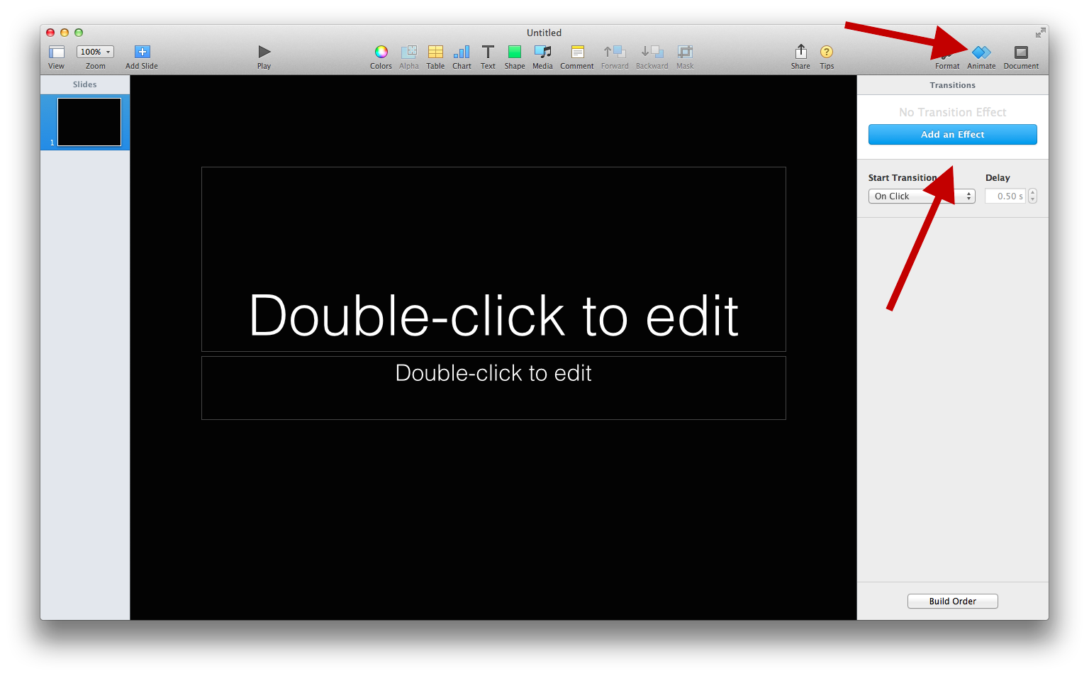

Check the Transition/Build settings of the last slide of Presentation A and the first slide of Presentation B.
No, there shouldn't be any issue doing this. As Dave said, you need to check your transitions between the last slide of deck A and the first slide of deck B.
Thanks for taking the time to do the screen capture. 🙂 Now I see what he meant by transitions! I should have known what he was talking about but I've been working since 4 am this morning. Aargh!
The thing is that I don't have any transitions in these slides at all. Both of these combined presentations are just 5 slides each made for the purposes of experimentation so I don't mess up my real Keynote presentation which is about 100 slides.
UPDATE: I just noticed that between the two slides it was set at Keynotes default which is Start Transition ON CLICK instead of AUTOMATICALLY so I selected AUTOMATICALLY and saved it and that didn't work, meaning that its still ignoring the B slides. Then I renamed it and saved it and that didn't work either. This is weird
