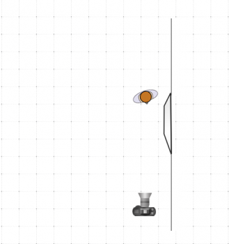

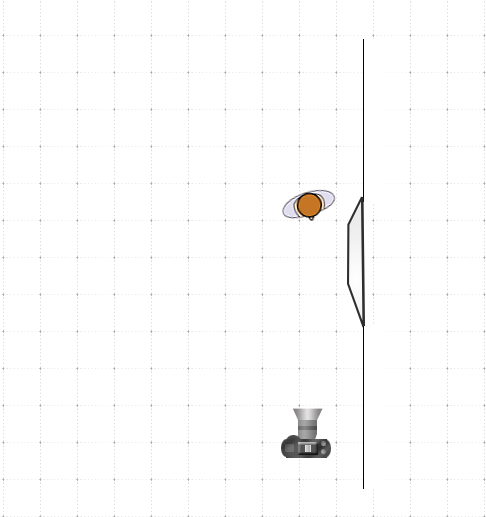

Everyone above is talking about the use of strobes to recreate this shot, and while I absolutely recommend learning about off-camera lighting, it's definitely not necessary here. Just use a big window on a slightly overcast day.
To recreate this particular shot, the window would be to the left of the subject (to the right of you & your camera). Don't place the subject in the centre of the window, but position them towards the back of the window so the light washes across the front of your subject (see set-up diagram). Use your 55-300mm lens set at about 100mm and f/5.6.
The lighting in this shot is very simple. What makes it interesting is the composition - you want to be shooting straight at the baby, not up or down. Pay attention to your rule of thirds - the baby's face is directly over the top-right intersection and the father's hand is very close to the bottom-right intersection. You don't need to worry about this when framing the shot - so much of the frame is solid black that you can frame it however you like in post.
Hope that helps.
