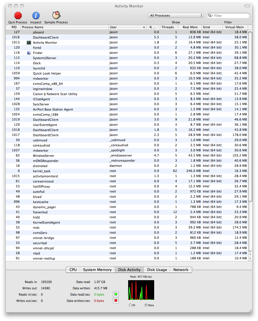

I did just notice something that could be involved in this. When perusing the list of processes that were running I observed that there was an istat process running, which I thought was weird because I had gone to install iStat Menus a few days ago but I did not go through with it (decided I didn't need another utility clobbering things up).
However, apparently, iStat Menus were 'installed' anyway as there is an iStat choice under my System Preferences folder. I went ahead and uninstalled it.
As promised, here is that screen shot of my running processes when sleep fails to happen;

Okay it just slept for the 1st time yet after removing iStat Menus. I'm wondering if iStat was in a 1/2 installed state, which was causing problems.
I'm going to try again here and see if it sleeps again, this time with one application active (iChat).
Okay looks like it might be fixed. Now slept a 2nd time. I am suspicious that iStat menu installation caused this problem and will see if I can gather some details.
