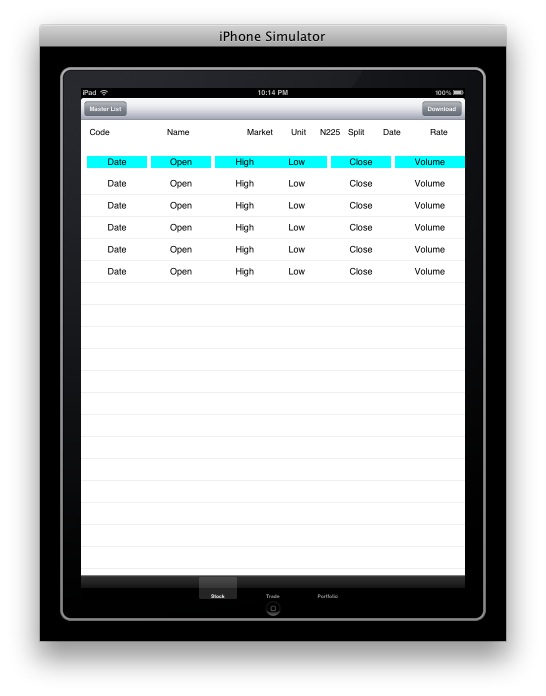

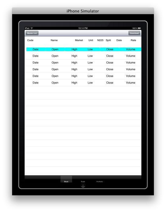

I have a View with two table views inside it. I want to set top of table view's background to cyan color, I used code as below, the cell color is getting to cyan, but the table view didn't, how can I set it to cyan color?
Code:
    tableView.backgroundColor = UIColor.cyanColor;
    cell.labelDate.backgroundColor = [UIColor cyanColor];
    cell.labelOpen.backgroundColor = [UIColor cyanColor];
    cell.labelHigh.backgroundColor = [UIColor cyanColor];
    cell.labelLow.backgroundColor = [UIColor cyanColor];
    cell.labelClose.backgroundColor = [UIColor cyanColor];
    cell.labelVolume.backgroundColor = [UIColor cyanColor];

I hope like this

Top table is only one row, I want to whole row background is set, though I can set cell background color, but there is gap between cells, I hope that gap is also the same background color, may I make sense?
