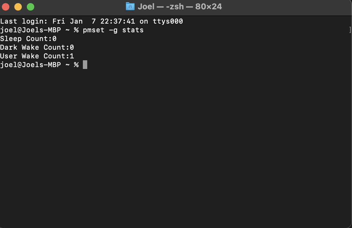

I am therefore confused based on the below image:
How is that I -- the User -- woke the computer once (i.e. User Wake Count: 1) when the computer never slept (Sleep Count: 0)?
Thanks.
Maybe it counts displaysleep and/or disksleep under User Wake Count.
So, the mac did not sleep, but the display did.
Appreciate the response but I am guessing it is something else as my Mac is setup not to sleep while the display is setup to sleep and often does sleep meaning that based on your interpretation, I would have expected that number (i.e. User Wake Count) to be higher.
Thanks.

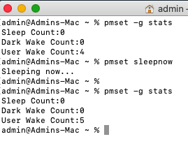

Mystery solved :)
"sleepnow - causes an immediate system sleep"
Appreciate that, the funny thing is that I do not recall ever issuing a command for the computer to sleep now but I guess I must have inadvertently done so when playing around with the pmset command.
That you for digging into this for me.
