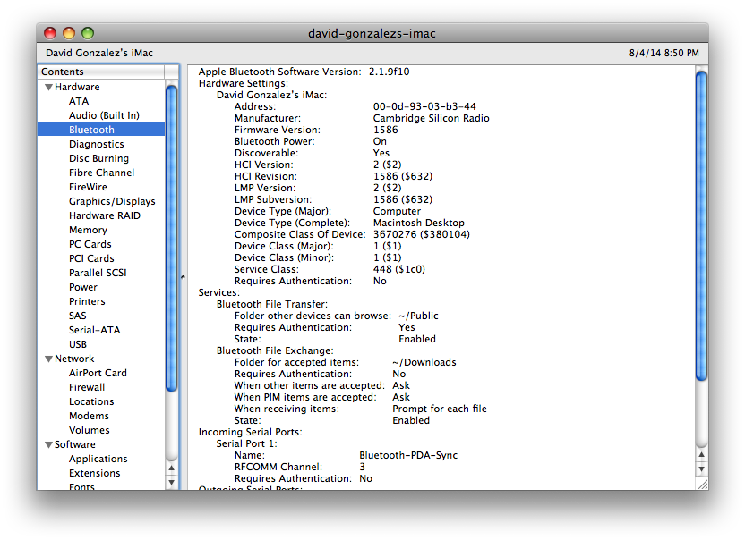

Here's what System Profiler says.

That iMac does have Bluetooth in it. Could it be that the mouse won't work with the iMac's older Bluetooth 1.X? It should still see it at least. Are you sure you put the mouse in discoverable mode? If you didn't, the iMac won't see it.
I held down the button on the bottom for a while. That's the same process I did when I paired it with my MBP and it connected with no issues. I guess the only way to really test is to use a bluetooth device. Maybe I'll look for an older MightyMouse on the cheap before buying one. That one should be compatible with the iMac.
