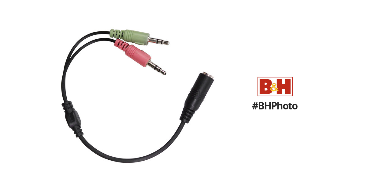

Front port is TRRS, but does not usually work well if you BootCamp. Some have used a workaround.
Optionally, look for something like this to use with rear ports:
Or use a cheap USB adapter like this is easier for a lot of people:
