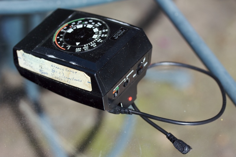

I've already found out that this flash is likely to fry any modern digital camera if mounted directly on the hotshoe. But can I use some converter instead? It has a cord (post connection?). Would a hot shoe to household adapter be what I need?
Most likely a PC terminal sync cord, providing your camera body supports that connection. A flash doesn't need to sit on a hot shoe to flash - it's getting a firing signal and optionally exposure information through the shoe. If it can accept a sync cord, and this flash certainly looks like it has one attached, then the firing signal can be triggered that way.
Thanks for the reply. My XSi doesn't have that connection, so I know I need some kind of adapter. What would that be called?
So, just to be sure: I won't have to worry about the flash frying my camera if I have one of those adapters connected instead of connecting the flash directly?
EDIT: I answered my own question. That cheap one won't reduce the voltage, so I'll need one like this: http://www.amazon.com/Wein-SSHSHS-Safe-Sync-Shoe-W990560/dp/B00009UU18/ref=cm_cr_pr_product_top
That cheap one isn't directly connected to the hot shoe, so it will be fine (edit: rather, the shoe isn't - it's a cold shoe). It is taking the signals off the hot shoe and sending them to the sync terminal. You connect the flash's sync cord to the sync terminal and that's the only electrical connection between the flash and the camera.

Ah yes, I forgot that the lower end cameras have the dinky contact closure circuits that can't handle the older strobes high sync voltage.
If you're electronically inclined, you can build yourself a fairly simple circuit to do the same thing, but it would probably just be easier to buy the hotshoe adapter that does it for you. $40 is a very reasonable price.
It would still be a problem, because the PC-sync voltage would still be too high for the camera to handle. Higher end cameras with PC sync ports will usually have a bigger mechanical relay to handle the increased voltages from studio strobes or older units, in many cases they are rated for up to 250VDC. In the cheaper cameras, sync is done by solid state device which will easily die if it tries to switch 200VDC.
Possibly, although without knowing which model that flash is one can't say for certain. And now it appears the question is moot. This page contains an interesting list: http://www.botzilla.com/photo/strobeVolts.html
Yeah, that's the page that initially led me to believe that I should not mount this flash on my XSi. The flash is a Popular 25CA, which is not listed, but the one flash by that manufacturer that is listed puts out 61-71V.
The question isn't quite moot, though. I also have two other old flash guns that I'd like to use: a Rollei and a Noaltron. And I still have some hope for the Popular; I'm going to try to clean up the corrosion.

(1) With a Wein "safe sync" there is no way you will "fry" the DSLR. It is not anything like "taking chances".
(2) Those flash units pictured, at least the three larger units, are very powerfull, high end units. Likely they are produce as much or more light then a Nikon SB800. Likely more. Replacing three for then with modern units would cost over $1,200
I use a Norman flash unit, like one of these (see link below) but mine was made about 35 years ago. It anything will "zap" a DSLR this thing will. But I've used it with several different medium format and Nikon film camera plaus my Nikon DSLR. If a "Safe Sync" a can work with an older Norman power ppack it can work with a little shoe mount flash

Just to update: everything ChrisA said in his last post turned out to be true. The Wein Safe Sync protects the camera perfectly, even when the big flash gun is plugged into the wall. These old flash guns put out an amazing amount of light (when my husband accidentally triggered one he was holding in his lap, with the bulb facing him, it singed the fleece he was wearing!).

Unlike Pentax (rumored to be 30V) or Canon (newer units are reportedly good to 250V, but older ones are 6V) all Nikon SLRs are good for 250V of flash, while there are a few units that'll put out more than that, they're very rare and the risks are much lower, so a Safe Sync or optical/radio trigger is a necessity for many shooters, but only slightly useful for a Nikon one (In other words, you're not really stretching the voltage envelope with Nikon and MF gear, put it on a Pentax and then you can use the "if anything" phrase...)
