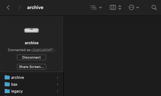

Also turn on screen sharing on the Mac Pro. In the Finder on the Mini, click on the shared disk icon for the Mac Pro and set the window view to Columns, there should be a button to share the screen - here's my 2012 Mini fileserver.
If you still have a screen connected to the Mac Pro, the window should be that size (it can auto-scale to fit). But if there's no screen connected, it may have an odd resolution. If you go to Amazon and search for "HDMI dummy plug" you will get lots of hits, they are very inexpensive, possibly $10 or even less (been a few years since I got one). Anyway, they can make the Mac Pro appear to have a screen. Or... does a Mac Pro even have an HDMI port? The closest thing I ever owned was a Power Mac G5! 🤣
Thanks, that was an amazing hint! :) Much better now … I've heard about that issue and the HDMI dummy, but so far it works. I do have an HDMI adapter (to which I connect my displays Mini DisplayPort), so I'll try it out if something doesn't work for some reason.
