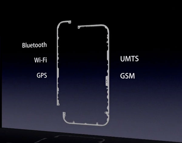

I actually thought it was the other way around, that this problem was mostly affecting left-handed people as it is the lower left area of the phone that is sensitive.
it primarily affects people who hold it in their left hand to use it for data purposes (aka. surf safari, type a text, view the screen, look up contacts, etc).
that's when the the bottom left corner gets blocked....not when you're holding it for a call (unless you're holding it while on speaker phone).
Here's why it affects left-handed users:
It also makes it quite obvious that the Apple Bumper was designed to shield this antenna, based upon its design.

When i completely cover the lower left corner and cover the top left corner, the most i can ever get it to drop is from 5 to 3 bars. I'm also left handed and always cover the lower left corner when i make a call but i always have a finger around the center of the top edge (as in not top left corner) and never have bars drop when i hold it like that, which is the way i normally hold it.
