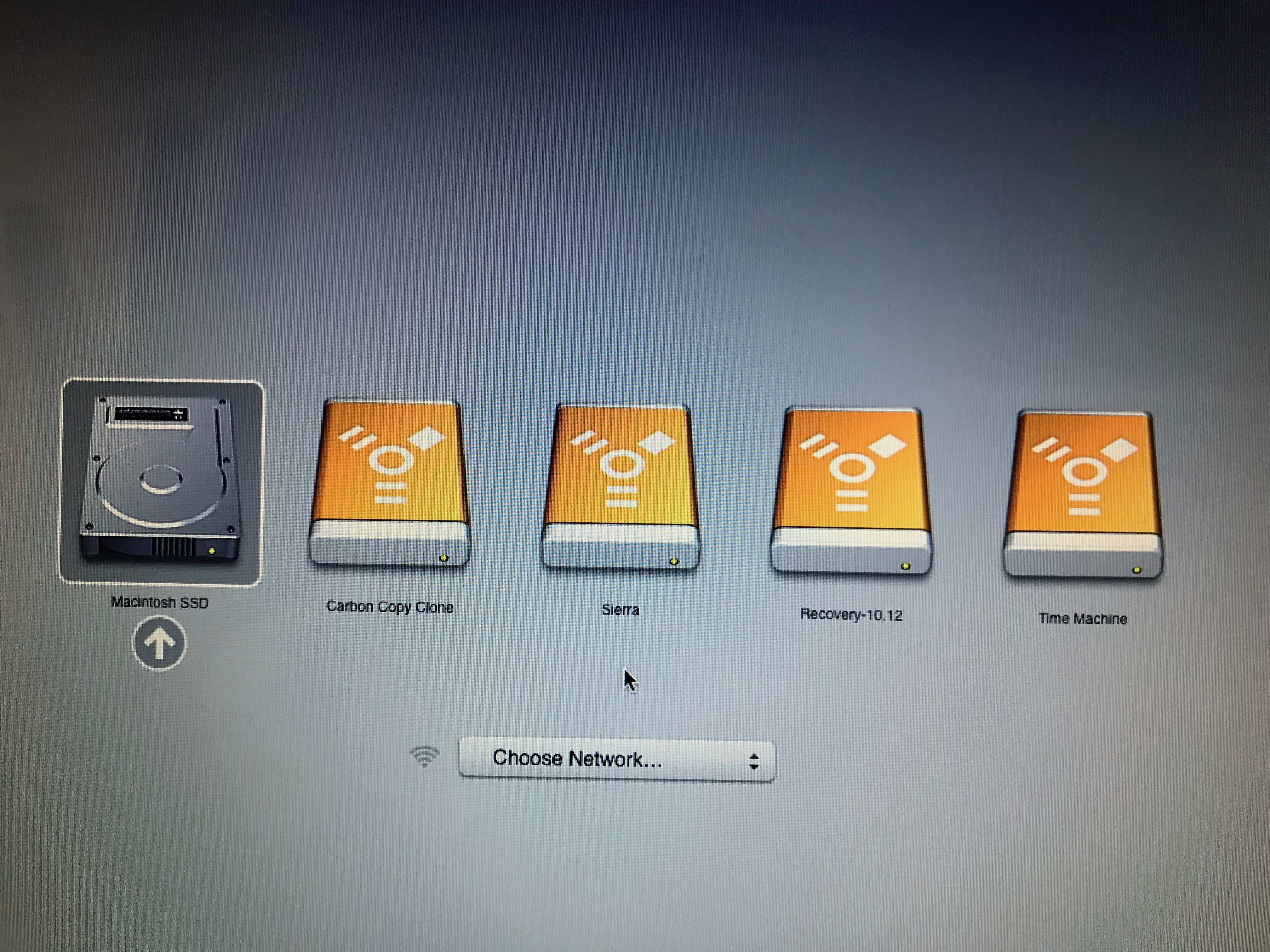

Well the good news is that I finished all my backups to my new FW800 external drive.
- imaged my install of PB4 using CCC (Carbon Copy Clone)
- copied my image of Sierra (before I took the beta plunge) using CCC (Sierra)
- TM'd my current install (Time Machine)
All if this to the new drive partitioned with HFS+ accordingly for each BU. Everything is bootable. I assume the recovery 10-12 volume below is the HS recovery volume? I hope I am pretty prepared for disaster now lol.
