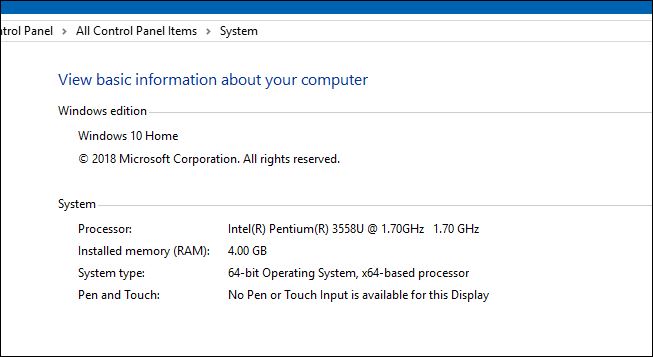

These are the details of the hardware:

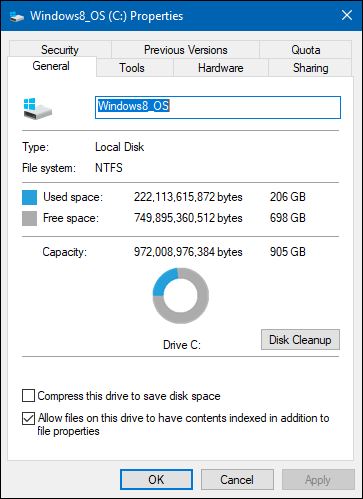

It has a hard disk drive:

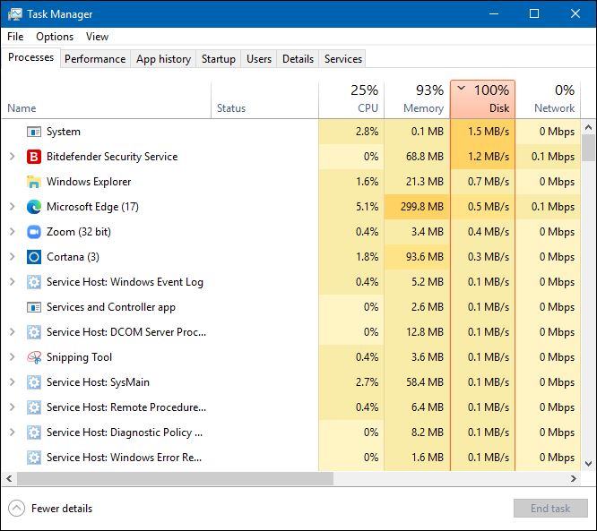

When it slowed right down just now I had a look at Task Manager and it looked like this, no idea if this is relevant at all

The Intel Pentium isn't a very fast processor. But, it's sufficient in this case because your PC is only using 25% of its power on your screenshot.
Secondly, these all-in-ones are typically laptop parts put into a desktop. If on the lower budget end, then that means parts such as your memory / RAM is soldered meaning you can't upgrade it. Your memory / ram is at 93% so it could do with being doubled to 8GB - if you can, go onto a site like www.crucial.co.uk and let it scan your system to tell you if it's upgradeable. Then, consider buying and installing it - there are guides online and it's generally easy for even novices to follow along.
Your obvious problem with the PC is Disk. This is the 'hard drive', storing all your content. I assume it's a spinning hard drive which is cheaper, slower but offers a lot of space. This is hopefully upgradeable (check Crucial's PC Scan also) to an SSD, which will be much much faster. It's the single best upgrade you can make to any compatible computer.
Other than improving the specification of the PC physically, you could go to the Startup tab in Task Manager and disable a lot of things that run automatically when you turn on the PC so it doesn't take so long trying to sort itself out each time you start it.

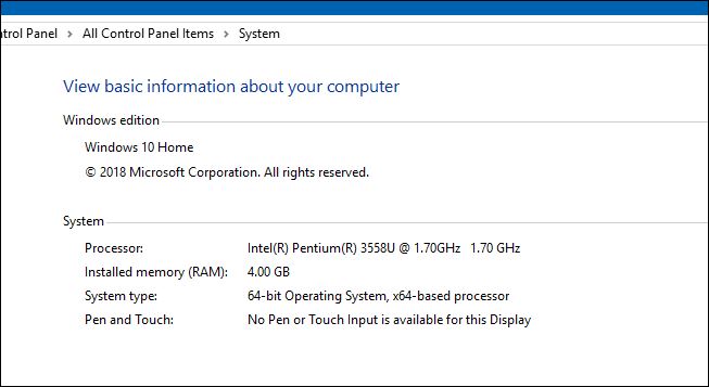

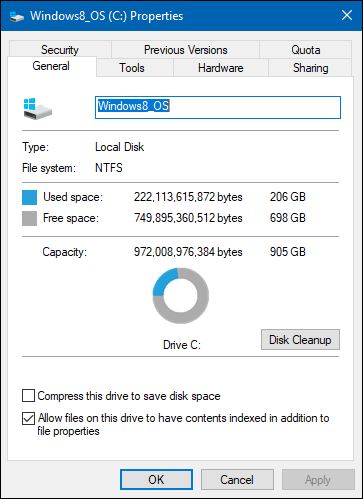

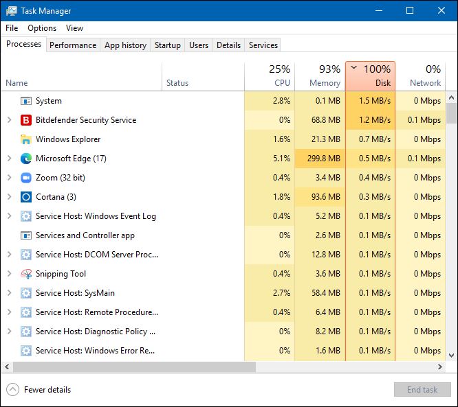

I don't exactly know how upgradable the Lenovo all-in-one is, but a view things spring to mind judging from what I see in the task manager (if possible on this machine):
  • Upgrade the RAM from 4 to 8 (or even 16) Gb.
  • Replace the HDD (I assume it is a mechanical hard drive) with an SSD.

If the hardware upgrades are not possible: at least clean up the hard drive (for what I see it does not have a lot of data on it anyway) and/or do a fresh install of Windows.
Don't expect miracles, because, as you said, it is a budget machine and the Pentium CPU is not the most powerful in the world. But replacing the HDD with an SSD and upping the RAM should help a lot.
