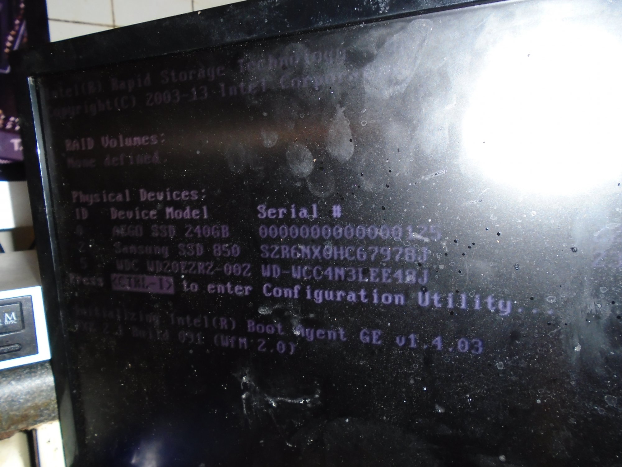

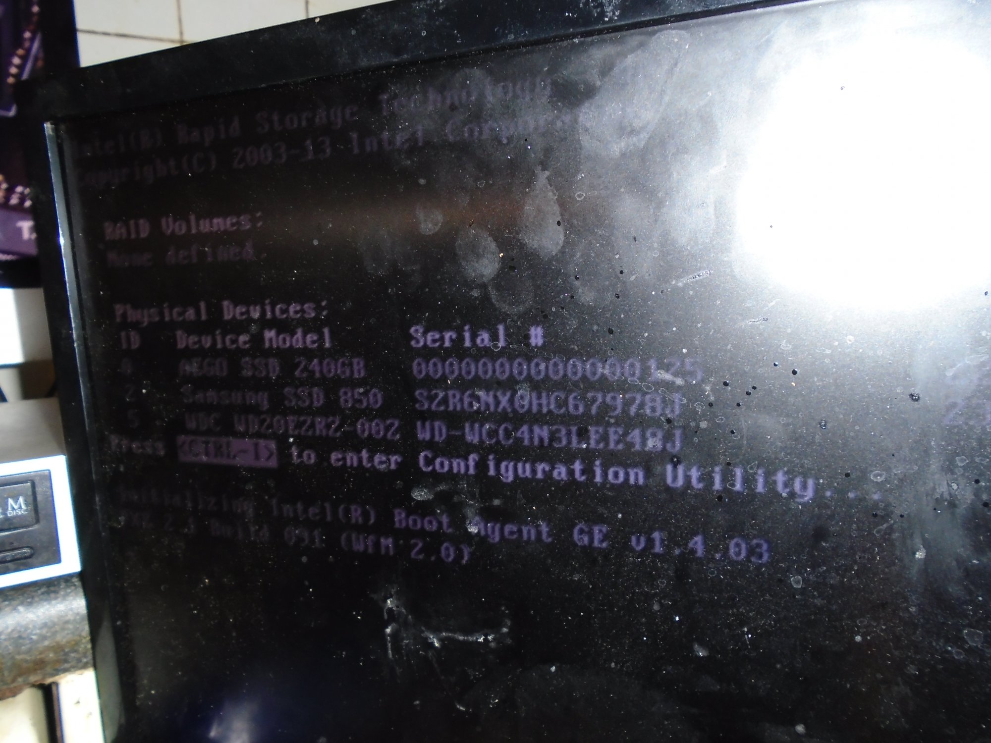

This is what comes. up.
I have a HP PC I press ESC it is touch and go that i get to boot F9. I also have a Dell PC i can chose the boot priority on there ,but i don,t see the same thing on the HP🙁When i do manage to F9 i stroll down to the drive i want to boot to.But the next time i turn on the PC it goes to the one on this photo below.

I would also recommend disabling RAID, in UEFI, if you are not using it as it looks like the system is doing a RAID controller scan instead of just booting off whichever disk you have Windows on.

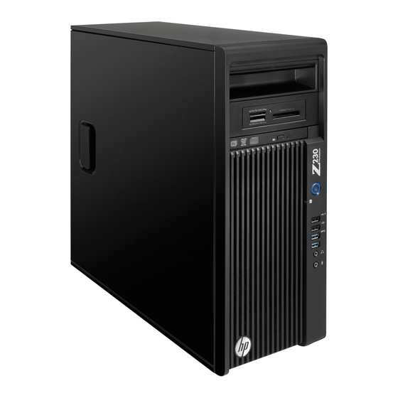

Thanks for that.The Dell menus are straight forward i just went and changed the boot order in there.There is not an option like that on HP.I tried to sign up to there forum but i never got the email confirmation to join.The modal of my PC is HPZ230. MT. I got it after my fav Aussie You tuber recommend it
he does mention something about secure boot .Up to that point i was going to get an optiflex i was put off by the low powered PSU.I made the mistake of getting a SFF Dell 3020 the only one that you could only put an 1030 card in there. thats how i know about the boot menus on Dell.Before i saw his video i was going to get a MT version.

For Step 4 does your system show Raid?
i don,t see anything about Raid.I have no idea what i am doing. 🙁I don,t see any boot menu .Why can,t it like Dell .

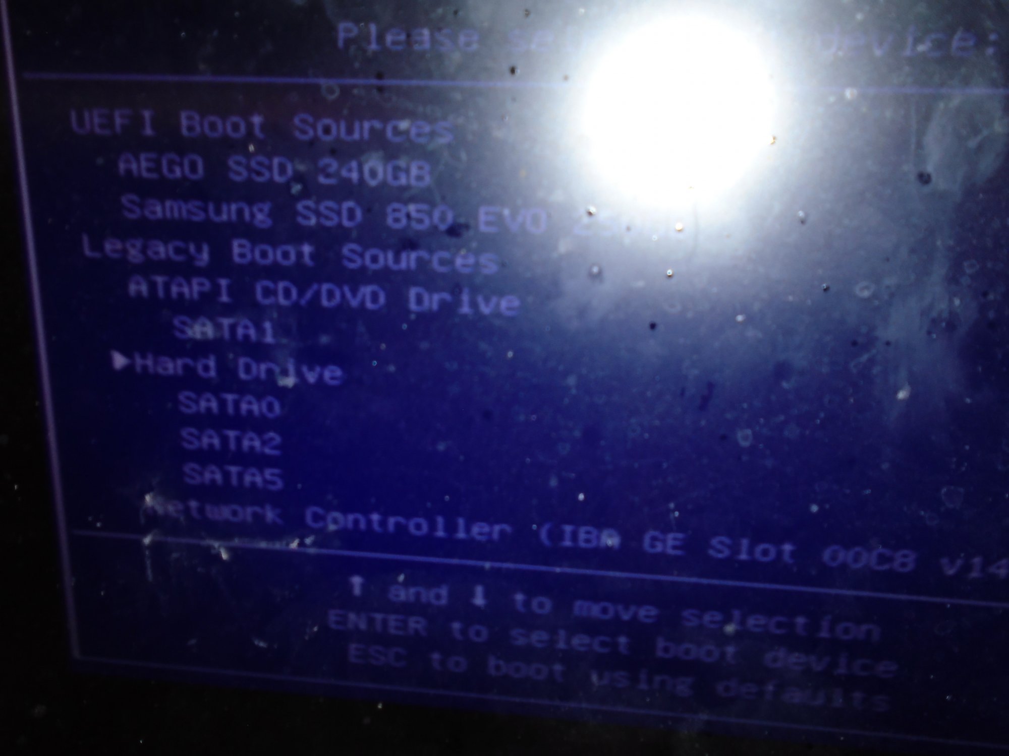

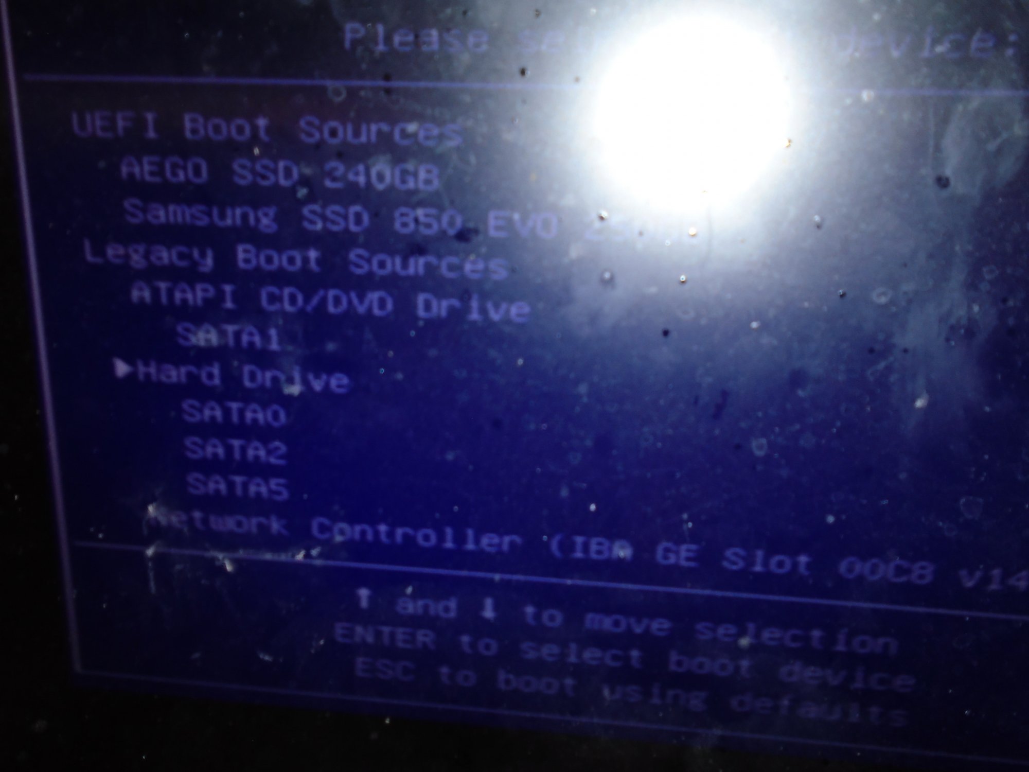

T9 Select boot device
*Uefi that is one of my os s I clicked that one to boot to this is what it said when i tried
*Attempting boot from cd rom boot from hard drive* nothing happens.?
BOOT Order
Uefi usb hard drive
cd/dvd drive
The same drive i tried to boot in before
Legacy boot the only drive it boots into .that is the tray made for SSD ,S.
Masterboot. disabled
connected bios Proxy. Disabled
Update Bios vie network enabled
Auto update Disabled
